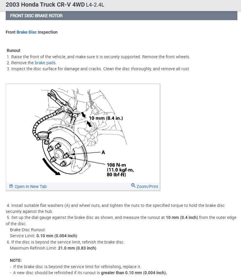

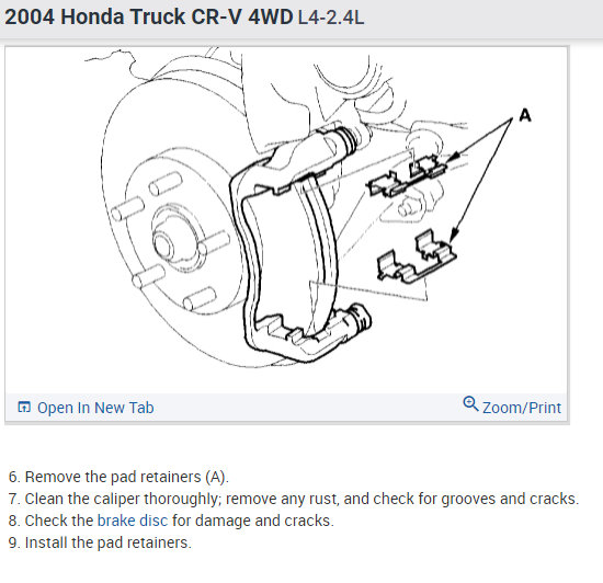

When changing my brakes I had to drill the two screws holding the disk ( two flat head M6X15, phillips socket). When I instaled the disk, I did not put them back. They seem there just for the intallation and not for holding?
Is this assasement good?
Thanks !
Thursday, November 19th, 2009 AT 12:58 PM
SQM
  • 6,383 POSTS
That is correct, those screws are not necessary. They are there to hold the rotor in place during assembly process.
However, it is best to install those screws if possible.

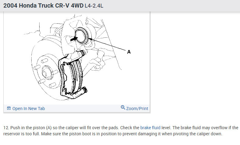

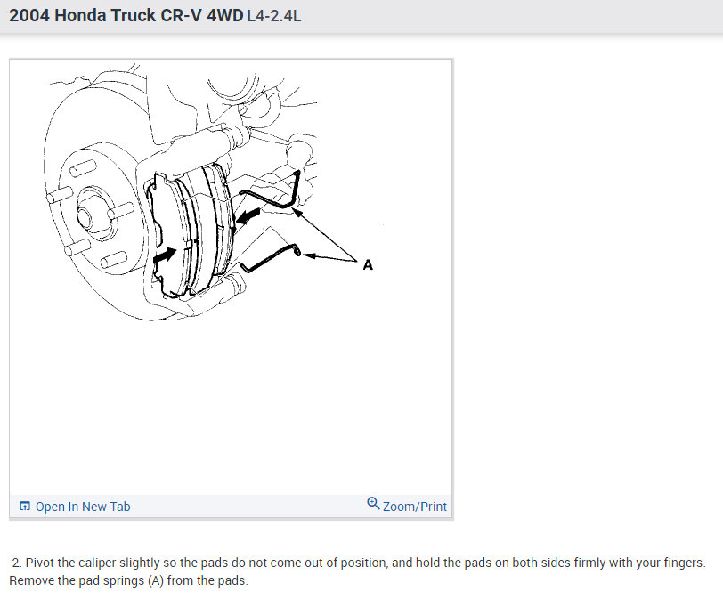

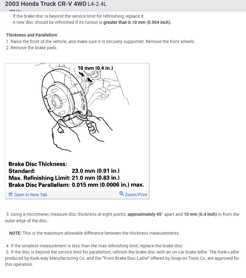

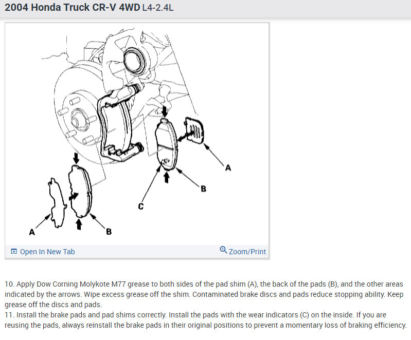

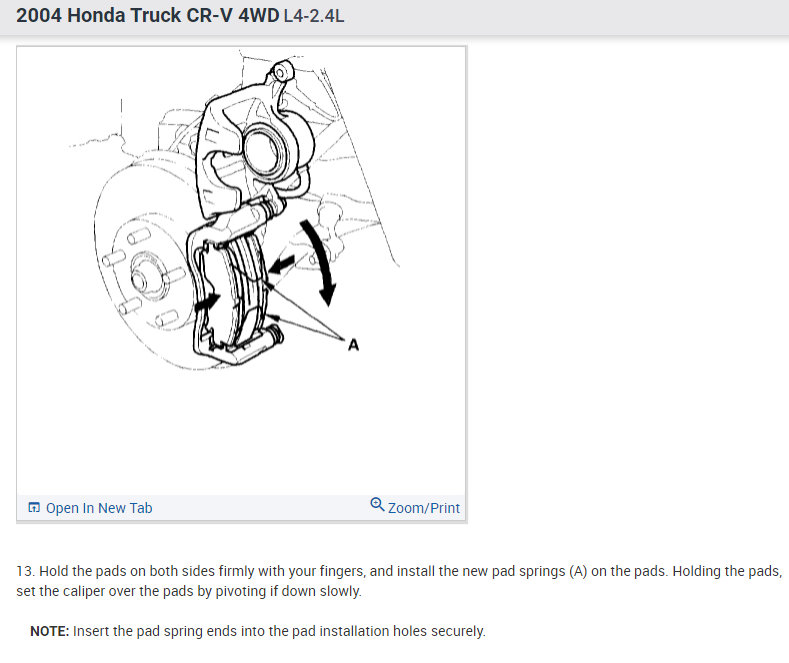

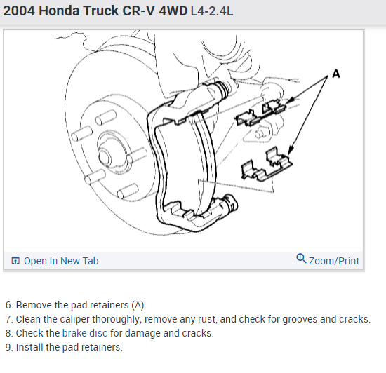

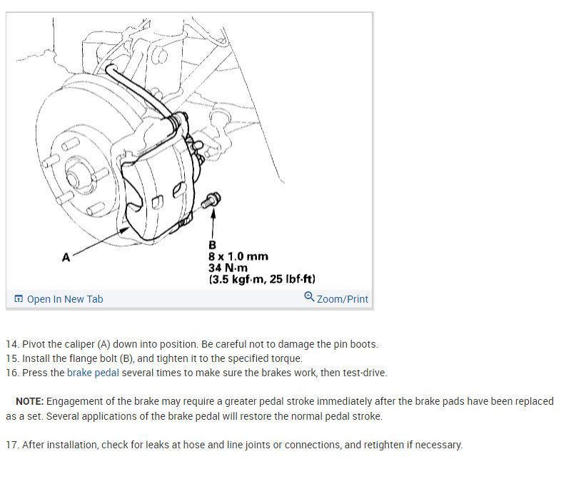

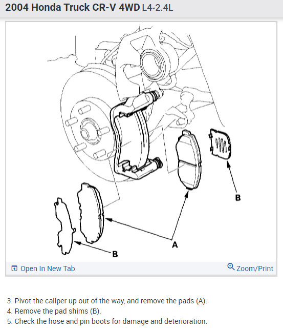

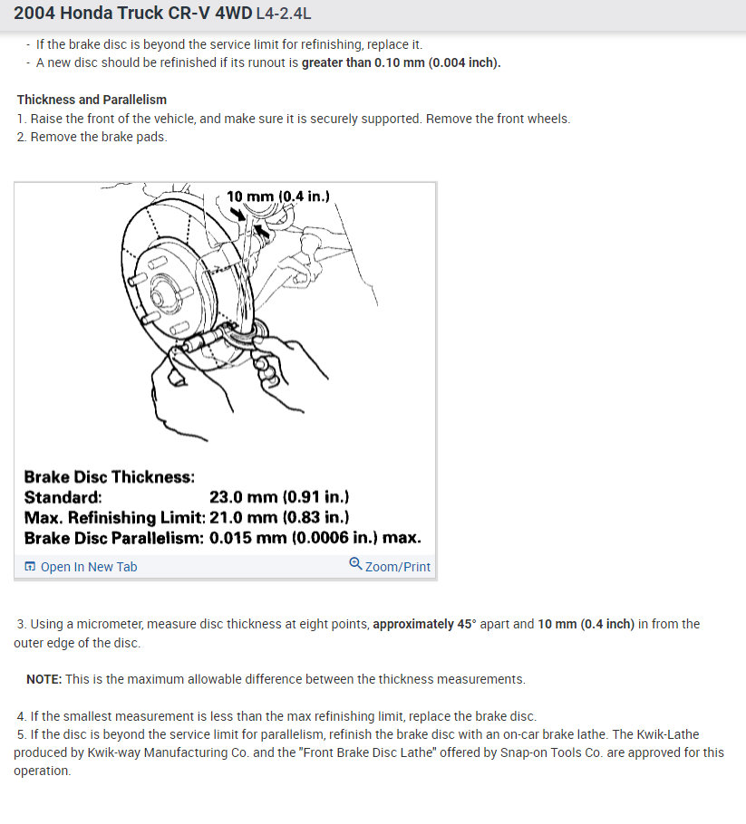

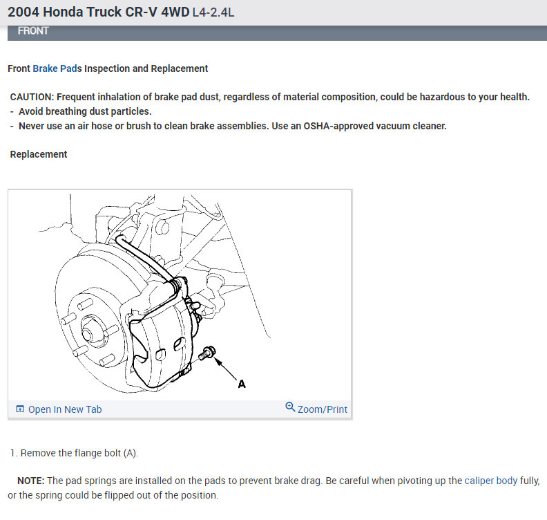

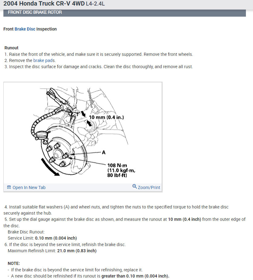

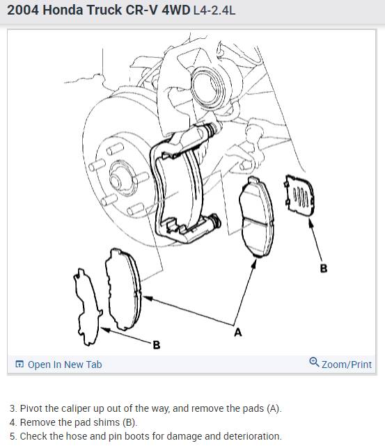

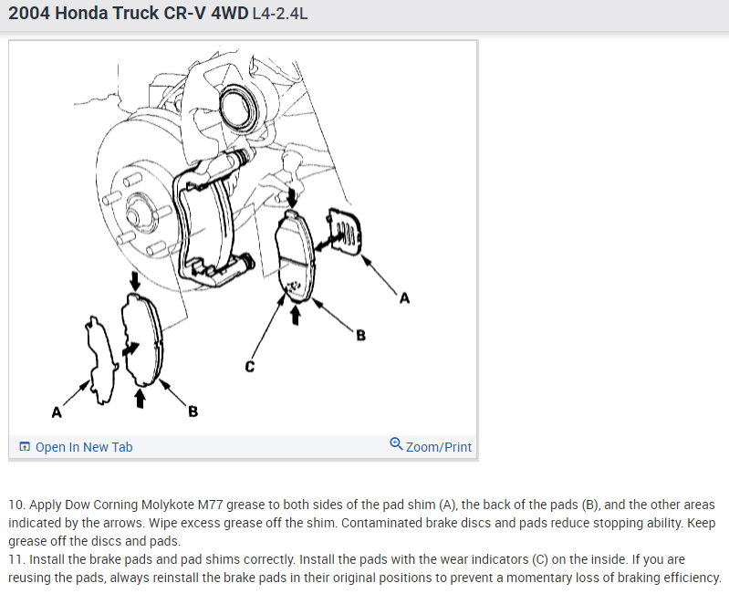

I have included the brake pads replacement procedures for anyone who might be looking for the instructions.
