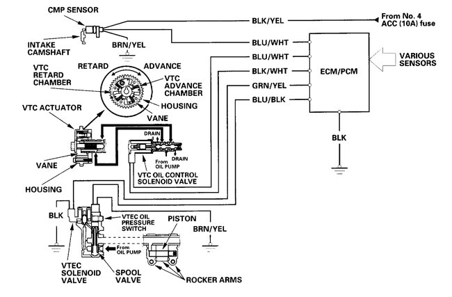

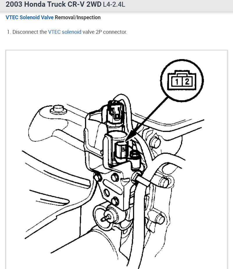

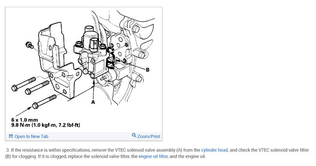

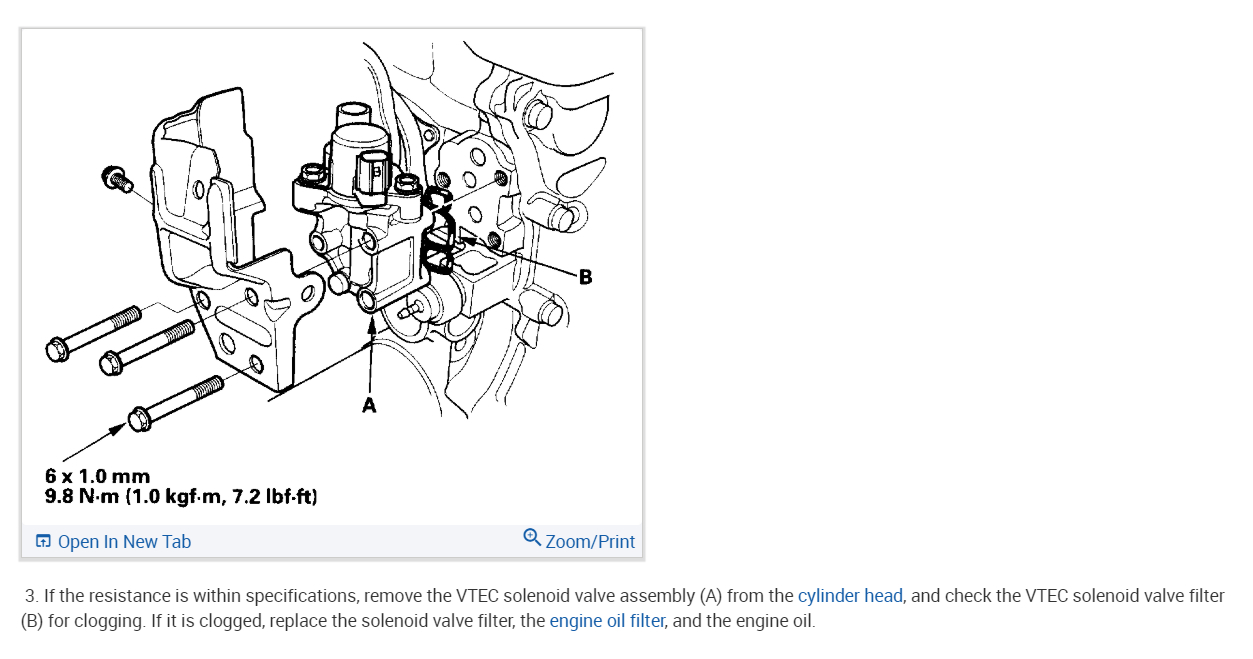

can you please tell me where the vtech solenoid and pressure switch are located thank you
Sep 9, 2008 at 2:50 AM
KHLOW2008
  • 41,814 POSTS
Hi eado,
I have found the vtec system identification diagrams and locations for you featured in the diagrams below. Check out the diagrams (Below). Please let us know what you find.
Sep 13, 2008 at 4:42 AM

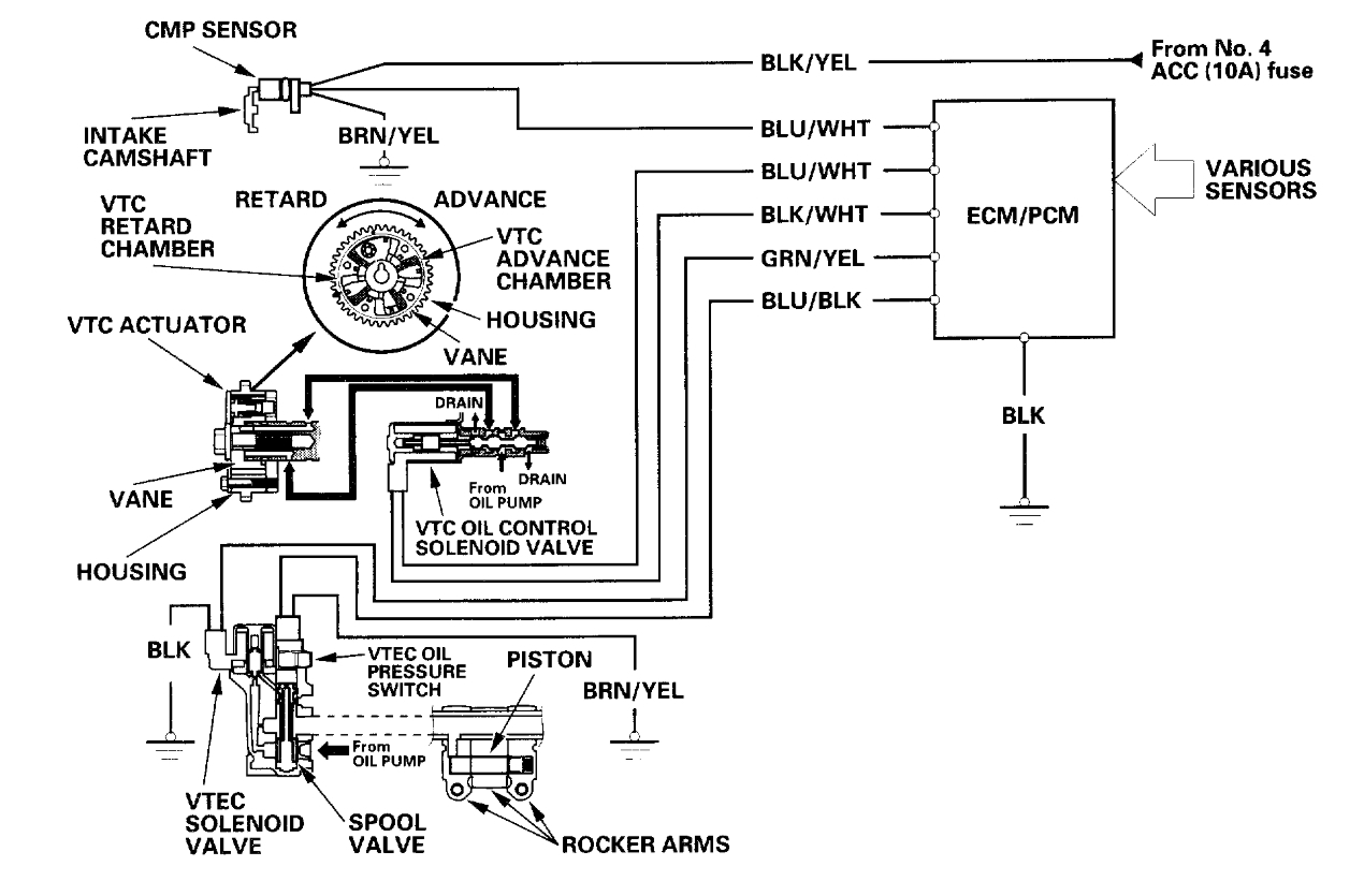

I just scanned a 2002 Honda CRV. Code: P1259 came up. The code mean there is something going on with the Vtech. What's wrong and how can it be fixed?
Thank you
Apr 30, 2020 at 4:16 AM (Merged)
HMAC300
  • 48,601 POSTS
try removing fuse #6 on underhood fuse panel with key off. keep itoff for 10 seconds then reinstall. if it comes on again have a pro run a scan and a few other checks onit.like ohms to pcm, oil siwtch volts etc.

I am so sorry for the delay. I tried that and it still made a strange noise. I looked further into it and found that the code represented that the oil pressure switch needed to be changed. I would like to know if that is correct and if so, what the steps to take for this. Thanks

engine must not be on. disconnect electrical connection, unscrew switch and revers to install.
