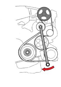

Four cylinder two wheel drive manual 100,000 miles.
Please I need urgently a diagram of how to change a four cylinder 2.4 engine's serpentine belt.
Please you would help me a lot!
The number of the belt is 7pk 1732.
Thanks a lot!

Try this. Jack.

Oh thanks a lot jack! Do you know the number of the serpentine belt?
We tried to put the serpentine belt as the diagram but we have a problem, the serpentine belt is smaller.
The diagram is very helpful.

Place the belt over all grooved pulleys and make sure it is on well then move the tension-er all the way and slide belt under it and if still short check with the part store you purchased it from. may be miss boxed or wrong part number
