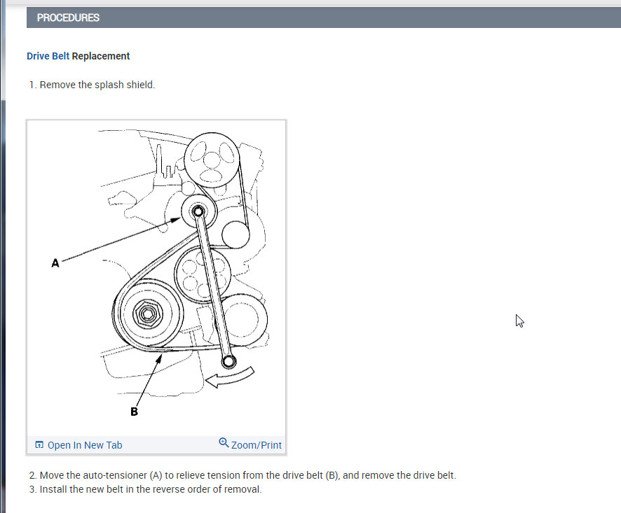

serpentine belt diagram?
2002 HONDA CRV
105,800 MILES • 4 CYL • 2WD • AUTOMATIC
GEORGE JD
you'd help me a lot if you know how to collocate a rib belt of the vehicle listed above.
the motor is 2.4 and the rib belt number is 7pk 1732.
thanks a lot!
Apr 2, 2008 at 11:18 AM
I am attaching the process from the manual on how to change this belt. Also, here is a guide that will help with more general information on replacing these belts:
