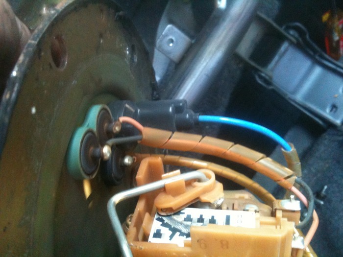

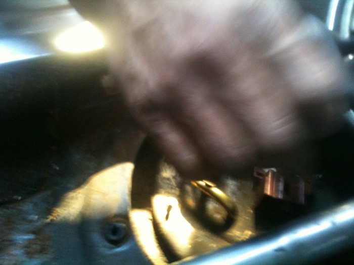

ATHENAK012002
Please excuse my technicality as I'm not a mechanic nor have much experience but I have someone shown me this today so I thought I would like to share with everyone.
So I did what AseMaster recommended by unplug the pink plug( see pics) and turned on the ignition. Sure enough the gas gauge went all the way down to empty. Next I remove the 2 plugs and the 2 fuel hoses(under the driver side rear seat) and remove the whole assembly. From the attached picture you will see the floater is actually connected to a metal rod which also connects with the metal sensor. Make sure the 2 metals are making contact or simply use fine sand paper to create a contact surface for both. After that, put everything back to its original place and plug everything back. Turn ignition on and you will get your meter back to normal. Good luck.

ATHENAK012002
I added some more fuel and the needle went up. It went back to normal like it supposed to be.

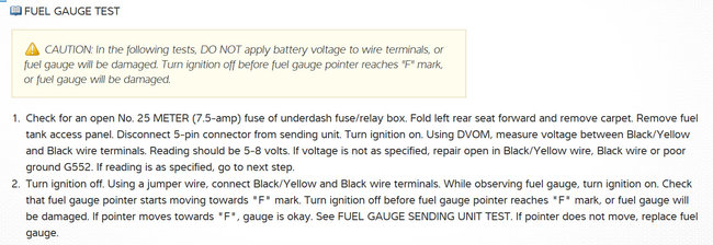

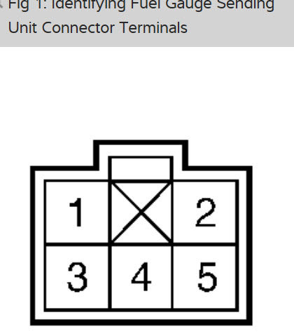

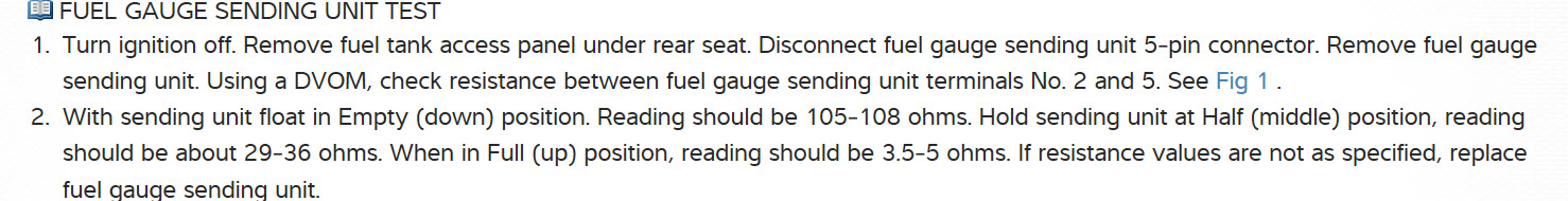

HMAC300
  • 48,601 POSTS
See pictures on how to test gauge and sending unit. If both are okay then it may be gauge wire grounding out.

Tuesday, October 1st, 2019 AT 6:24 PM (Merged)
ATHENAK012002
The needle only dropped off when you unplug the sender unit otherwise it stayed the same constant position.
