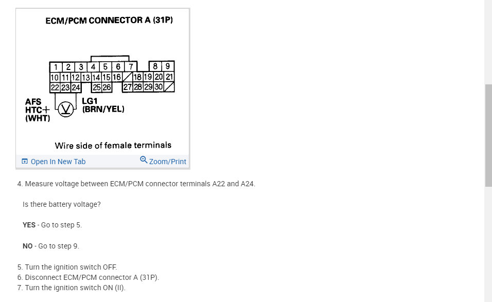

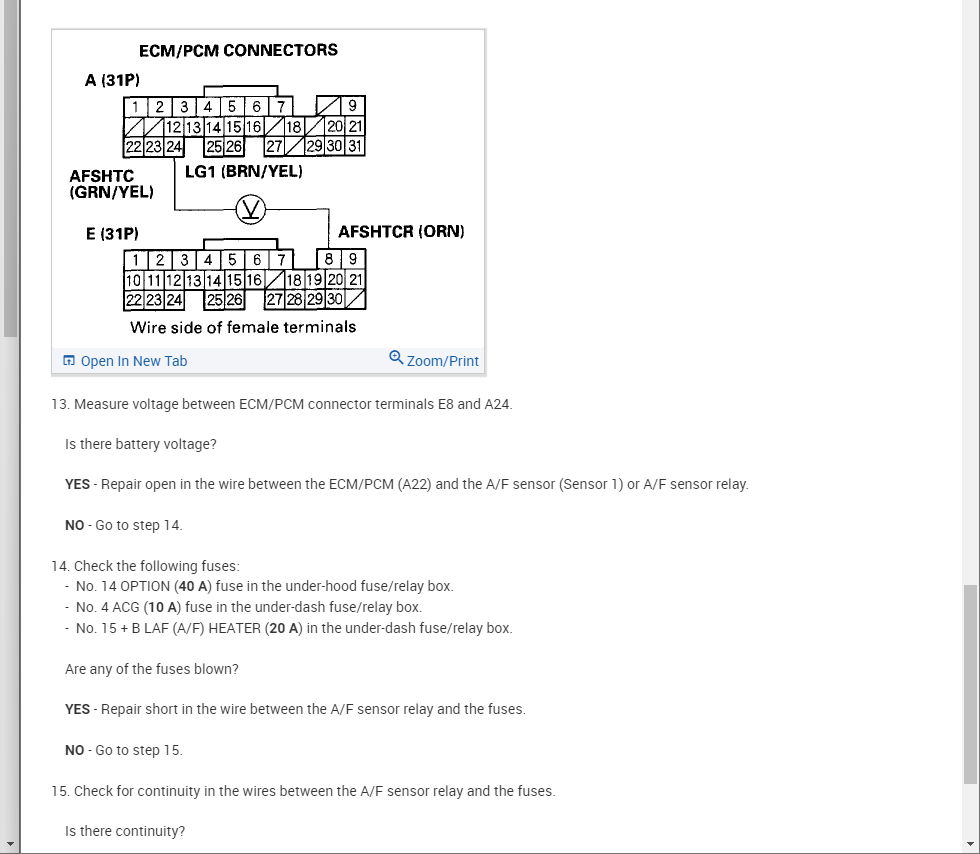

Two codes coming up, P1166 and P1167. Heater Circuit fault what is it, and how to fix?
Sep 2, 2009 at 11:06 AM

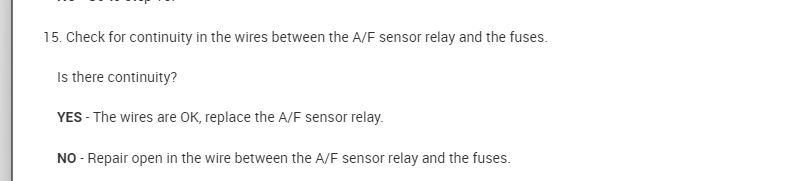

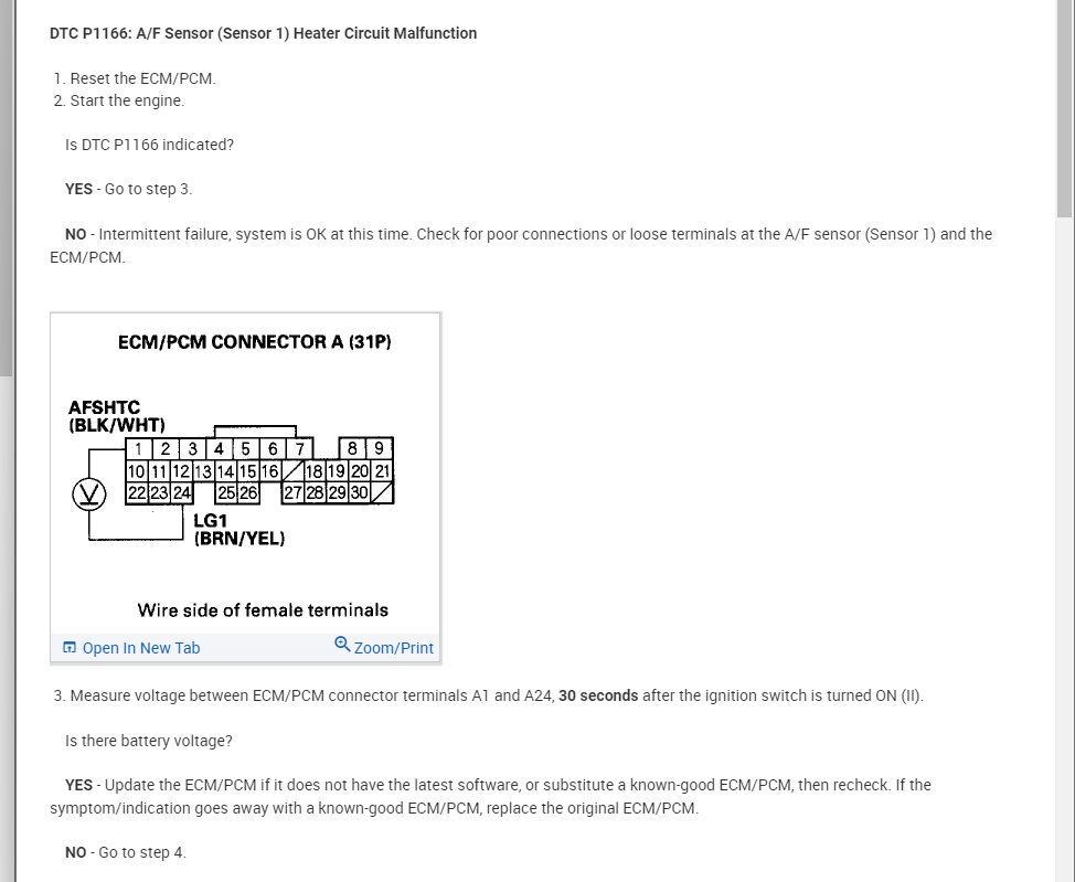

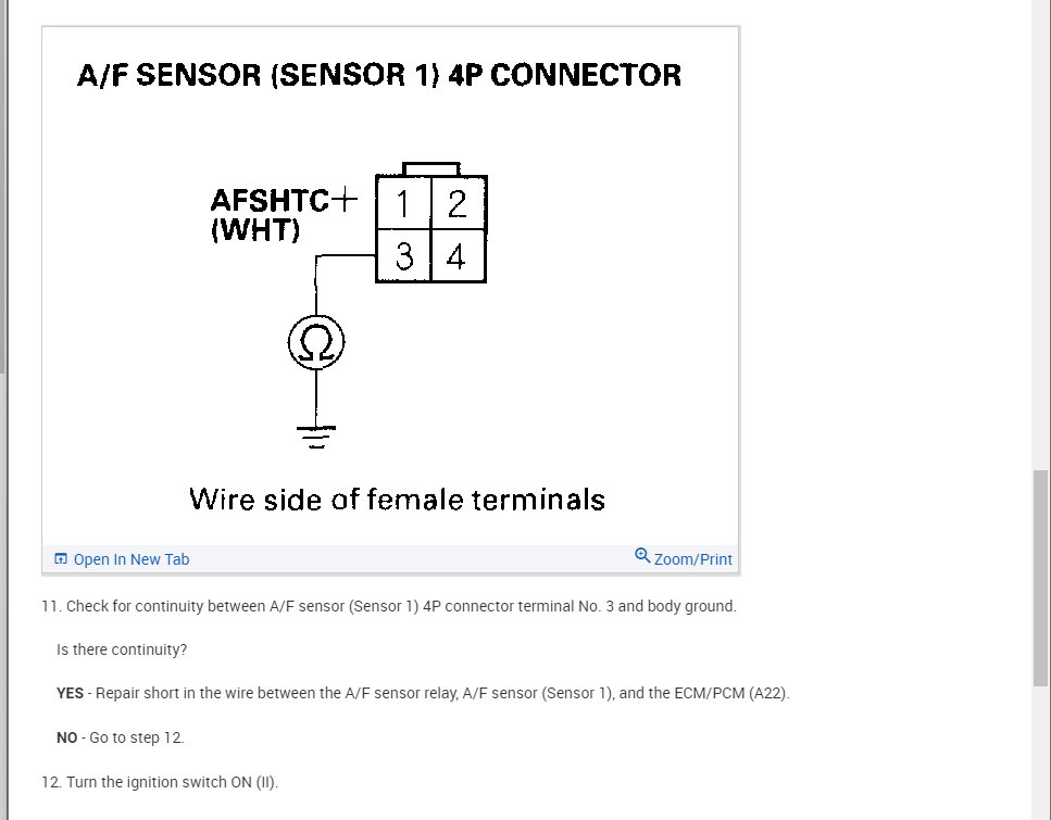

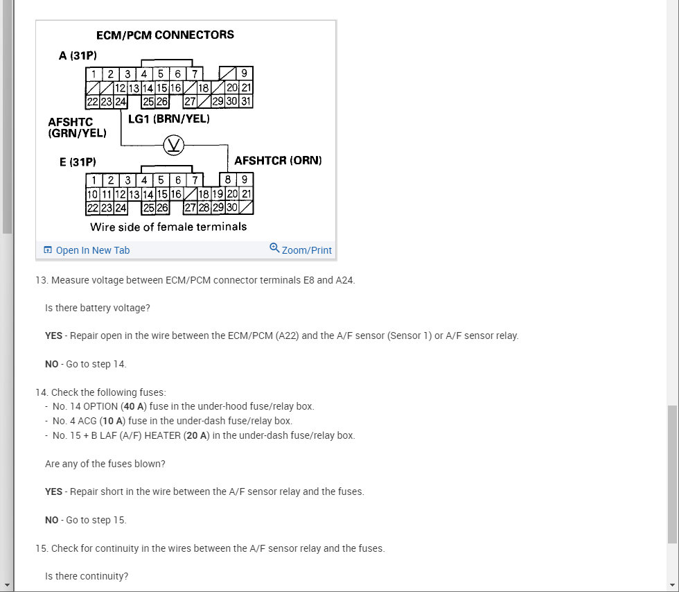

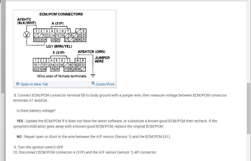

These are o2 sensor codes. So, we need to run through the testing attached in order to determine what the issue is.
However, here are a couple of guides that will help with this:
https://www.2carpros.com/articles/how-to-test-an-oxygen-sensor-02-sensor
https://www.2carpros.com/articles/how-to-replace-an-oxygen-sensor
Please follow the testing below and let us know what questions you have, and we can go from there.
