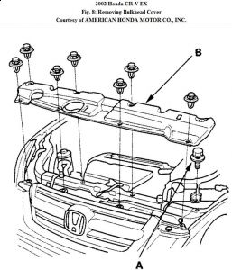

After market or remans tends to fail much earlier than OEM so I would advise against non OEM parts if possible. However you might get lucky with a reman which would last you for some time. Here are the replacement procedures. ALTERNATOR Removal 1. Disconnect the negative cable from the battery first. Disconnect the positive cable. 2. Remove the bolt "A" securing the battery clamp. Remove the bulkhead cover "B". See Fig.8.
https://images.2carpros.com/forum/automotive_pictures/192750_AlternatorRepalcement02CRVFig08_1.jpg

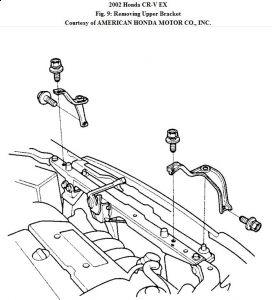

3. Remove the upper brackets and cushions. See Fig. 9.
https://images.2carpros.com/forum/automotive_pictures/192750_AlternatorRepalcement02CRVFig09_1.jpg

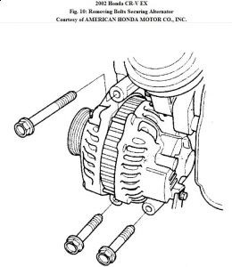

4. Remove the drive belt. 5. Remove the auto-tensioner. 6. Remove the three bolts securing the alternator. See Fig. 10.
https://images.2carpros.com/forum/automotive_pictures/192750_AlternatorRepalcement02CRVFig10_1.jpg

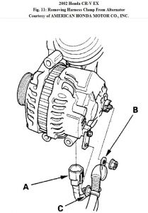

7. Disconnect the alternator connector "A" and Black wire "B", and remove the harness clamp from the alternator. See Fig. 11.
https://images.2carpros.com/forum/automotive_pictures/192750_AlternatorRepalcement02CRVFig11_1.jpg

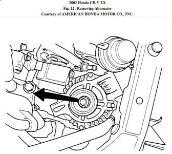

8. Remove the alternator. See Fig. 12.
https://images.2carpros.com/forum/automotive_pictures/192750_AlternatorRepalcement02CRVFig12_1.jpg
Installation 1. Install the alternator and drive belt in the reverse order of removal. 2.Install the upper brackets and cushions, ensure they are set securely. 3.Connect the positive cable and negative cable to the battery. 4. Enter the anti-theft code for the radio. Enter the customer's radio station presets. 5. Set the clock. 6. Perform the ECM PCM idle learn procedure, and the power window control unit reset procedure.
