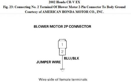

The fan blower motor is not working and you need to find out why. See if the following is of any help. A Problem in the Blower Motor Circuit 1 . Check the No. 12 (40A) fuse in the under-hood fuse/relay box, and the No. 14 (10A) fuse in the under-dash fuse/relay box. Are the fuses OK ? YES - Go to step 2. NO - Replace the fuse(s), and recheck. 2 . Connect the No. 2 terminal of the blower motor 2P connector to body ground with a jumper wire.
https://images.2carpros.com/forum/automotive_pictures/192750_BlowerMotor02CRVFig23_1.jpg

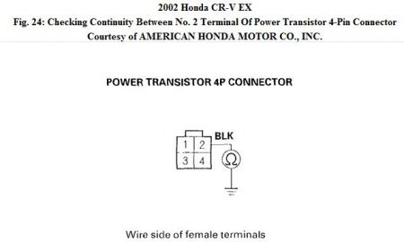

3 . Turn the ignition switch ON (II). Does the blower motor run? YES - Go to step 4. NO - Go to step 17 . 4 . Turn the ignition switch OFF. 5 . Disconnect the jumper wire. 6 . Disconnect the power transistor 4P connector. 7 . Check for continuity between the No. 2 terminal of the power transistor 4P connector and body ground.
https://images.2carpros.com/forum/automotive_pictures/192750_BlowerMotor02CRVFig24_1.jpg

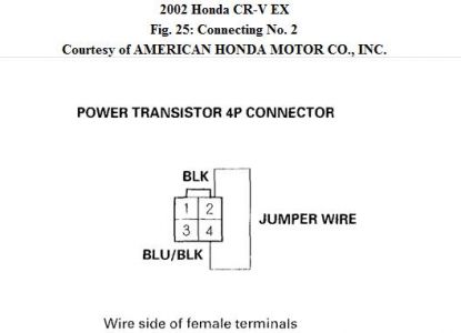

Is there continuity? YES - Go to step 8. NO - Check for an open in the wire between the power transistor and body ground. 8 . If the wire is OK, check for poor ground at G501. Connect the No. 2 and No. 4 terminals of the power transistor 4P connector with a jumper wire.
https://images.2carpros.com/forum/automotive_pictures/192750_BlowerMotor02CRVFig25_1.jpg
9 . Turn the ignition switch ON (II). Does the blower motor run at high speed? YES - Go to step 10. NO - Repair open in the wire between the power transistor and the blower motor. 10 . Turn the ignition switch OFF. 11 . Disconnect the jumper wire. 12 . Disconnect the heater control panel 30P connector. 13 . Check for continuity between the No. 16 and No. 17 terminals of the heater control panel 30P connector and body ground individually.

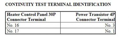

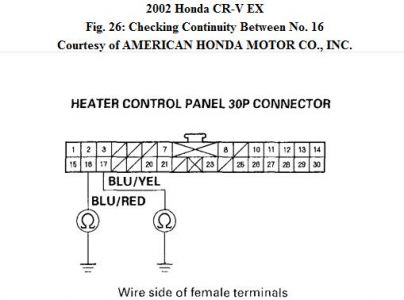

Is there continuity? YES - Repair any short to body ground in the wire(s) between the heater control panel and the power transistor. NO - Go to step 14. 14 . Check the continuity between the following terminals of the heater control panel 30P connector and the power transistor 4P connector.
https://images.2carpros.com/forum/automotive_pictures/192750_BlowerMotor02CRVFig26a_1.jpg

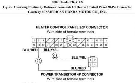

https://images.2carpros.com/forum/automotive_pictures/192750_BlowerMotor02CRVFig27_1.jpg
Is there continuity? YES - Go to step 15. NO - Repair any open in the wire(s) between the heater control panel and the power transistor. 15 . Reconnect the heater control panel 30P connector. 16. Test the power transistor (see Power Transistor Test ). Is the power transistor OK ? YES - Check for loose wires or poor connections at the heater control panel 30P connector and at the power transistor 4P connector. If the connections are good, substitute a known-good heater control panel, and recheck. If the symptom/indication goes away, replace the original heater control panel. NO - Replace the power transistor. 17 . Disconnect the jumper wire. 18 . Disconnect the blower motor 2P connector. 19 . Measure the voltage between the No. 1 terminal of the blower motor 2P connector and body ground.

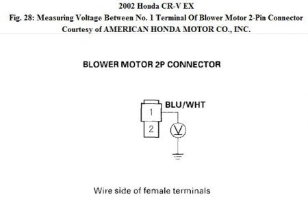

https://images.2carpros.com/forum/automotive_pictures/192750_BlowerMotor02CRVFig28_1.jpg

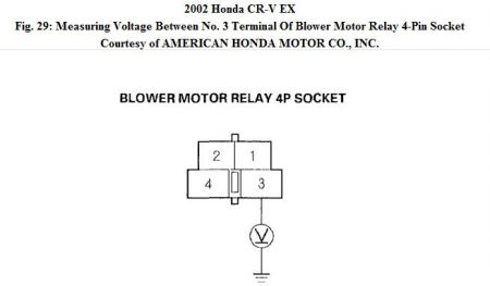

Is there battery voltage? YES - Replace the blower motor. NO - Go to step 20. Turn the ignition switch OFF. 21. Remove the blower motor relay from the under-hood fuse/relay box, and test it. Is the relay OK? YES - Go to step 22. NO - Replace the blower motor relay. 22 . Measure the voltage between the No. 3 terminal of the blower motor relay 4P socket and body ground.
https://images.2carpros.com/forum/automotive_pictures/192750_BlowerMotor02CRVFig29_1.jpg

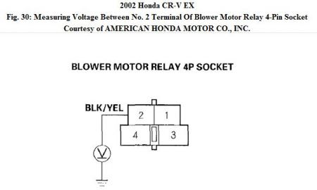

Is there battery voltage? YES - Go to step 23. NO - Replace the under-hood fuse/relay box. 23 . Turn the ignition switch ON (II). 24. Measure the voltage between the No. 2 terminal of the blower motor relay 4P socket and body ground.
https://images.2carpros.com/forum/automotive_pictures/192750_BlowerMotor02CRVFig30_1.jpg
Is there battery voltage? YES - Go to step 25. NO - Repair open in the wire between the No. 14 fuse in the under-dash fuse/relay box and the blower motor relay. 25 . Turn the ignition switch OFF. 26 . Check for continuity between the No. 1 terminal of the blower motor relay 4P socket and body ground.

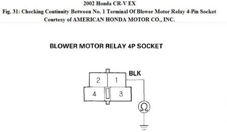

https://images.2carpros.com/forum/automotive_pictures/192750_BlowerMotor02CRVFig31_1.jpg
Is there continuity? YES - Repair open in the BLU/WHT wire between the blower motor relay and the blower motor. NO - Check for an open in the wire between the blower motor relay and body ground. If the wire is OK, check for poor ground at G301.
