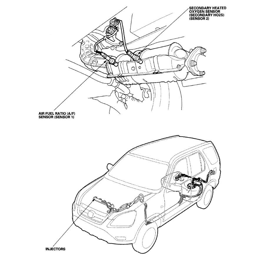

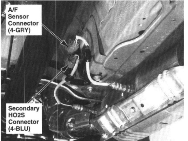

I am trying to find the least expensive way to replace the 02 sensors on a 2002 honda crv. I have found inexpensive ones on the enternet and would like to know if they can be used.
and where are the sensors located?

Hi jon,
There is a Chinese saying, every cent is worth its quality. Usability is not a problem but reliability is a question mark.
There are 2 sensors, located before and after the catalytic converter on the exhaust system under the vehicle
Here's a guide on how to replace the oxygen sensor
https://www.2carpros.com/articles/how-to-replace-an-oxygen-sensor
See the pictures below for locations

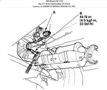

DEEPAK05
  • 5 POSTS
COuld you please give me the diagram to locate the Oxygen sensor?
Inorder to check the sensor, I just need a multi meter correct? I will purchase one and do the check

KHLOW2008
  • 41,814 POSTS
Sorry for the mistake.
I was suppposed to attach a diagram and seem to miss it out after answering the question.
https://www.2carpros.com/forum/automotive_pictures/192750_AFsensor02CRVFig137_2.jpg

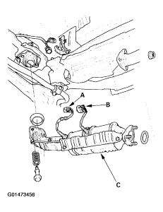

MPENDERGAST912
  • 2002 HONDA CRV
  • 4 CYL
  • AWD
  • 75,600 MILES
I took my CR-V to auto zone when the engine light lit up to see what the problem was. The codes that he retrieved said that there was a problem with the O2 sensor in the car. I can not seem to locate the sensor or sensors if there are more than one. The Haynes manual I have is a little vague on the location so here I am. Thanks in advance.

KHLOW2008
  • 41,814 POSTS
Hi mpendergast912,
A = primary O2 sensor.
B = secondary O2 sensor.
C = Catalytic converter.
https://www.2carpros.com/forum/automotive_pictures/192750_O2SensorHonda_1.jpg
