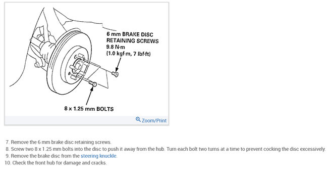

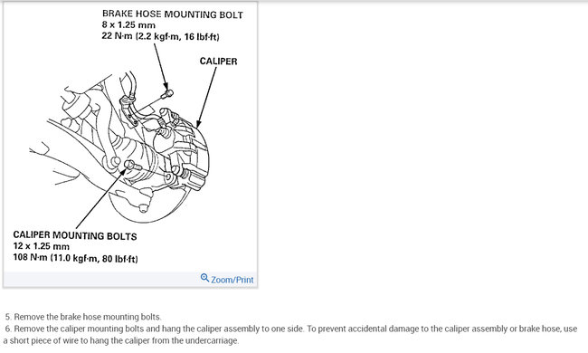

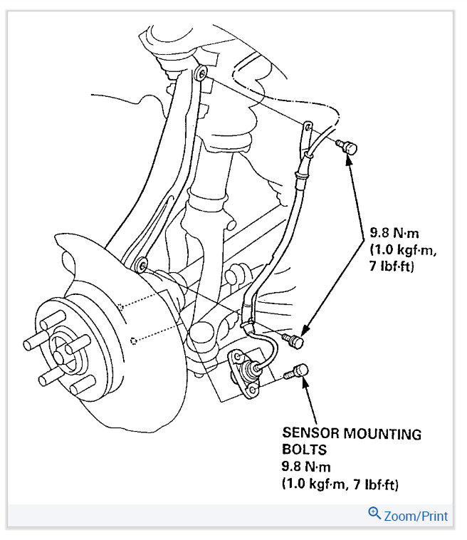

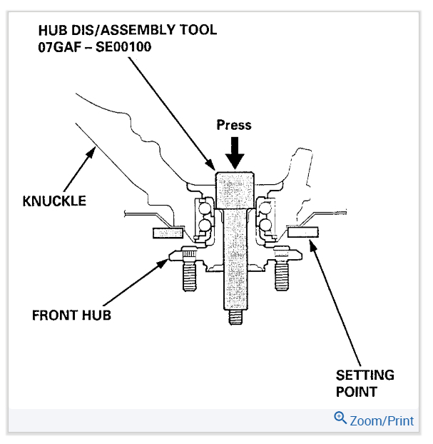

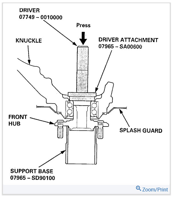

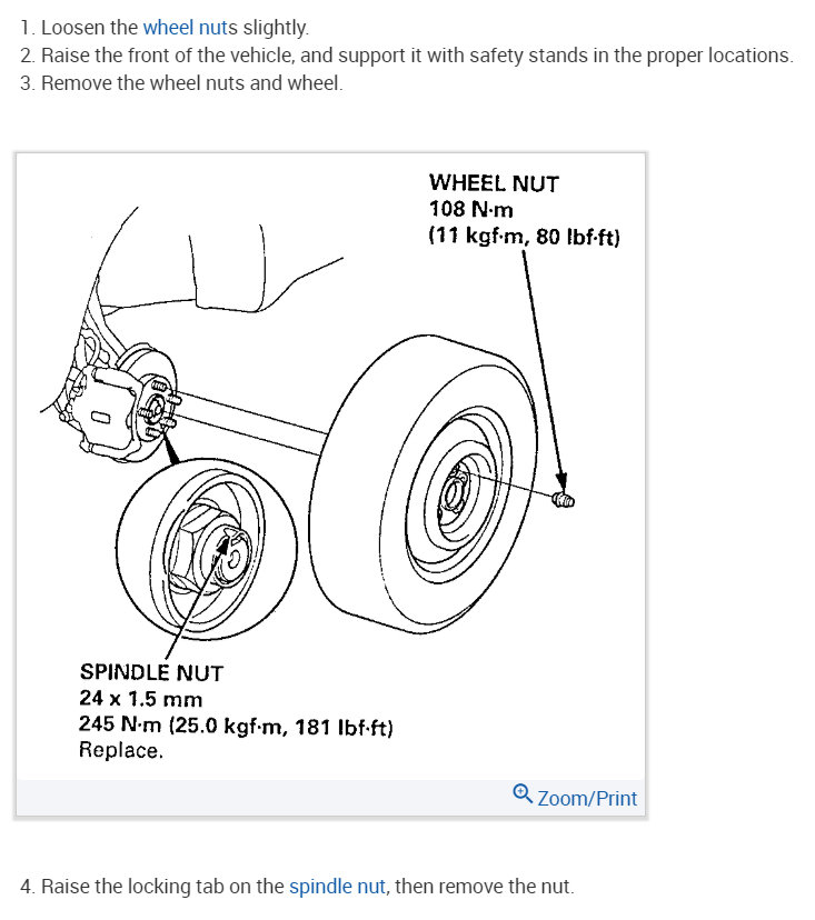

How can I change a broken wheel stud on the front wheel?
Jan 28, 2009 at 3:51 AM
F4I_GUY
Experienced Mechanic
3,302 POSTS

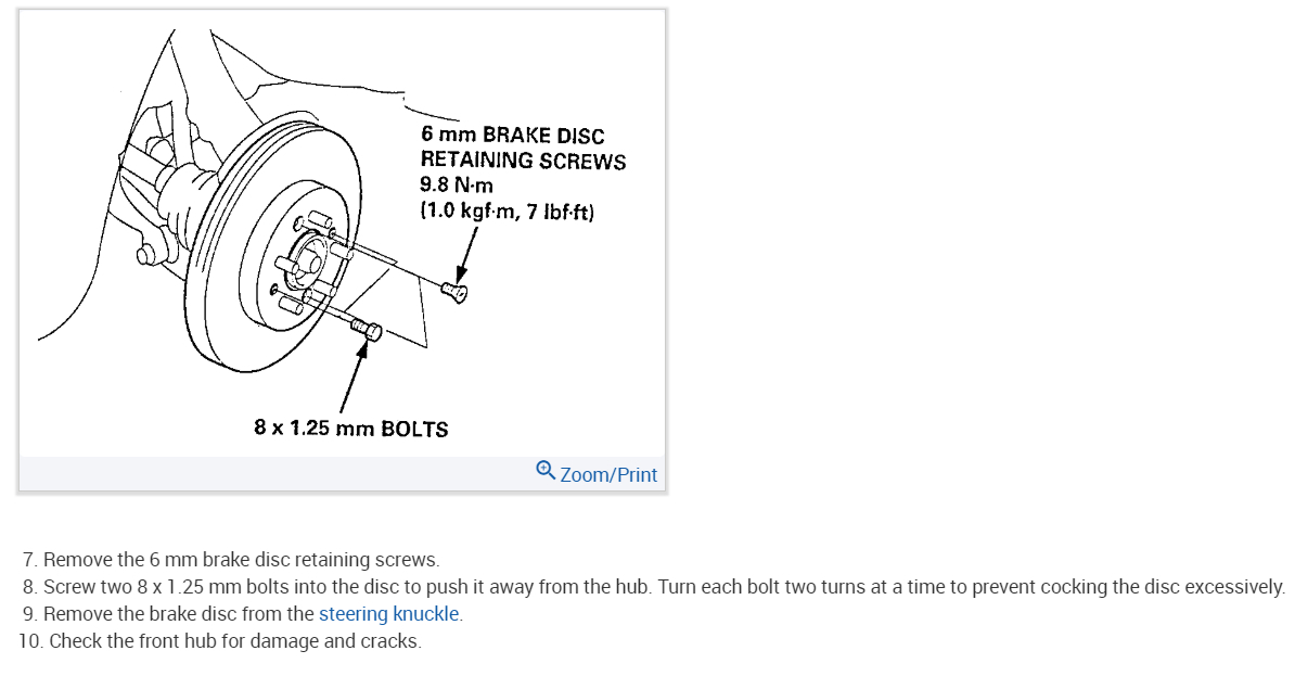

This one will take some doing first you need to remove the spindle and hub here is a guide to show you how this guide has most of the steps
https://www.2carpros.com/articles/how-to-replace-a-cv-axle-bearing
You will need to undo the tie rod as well.
https://www.2carpros.com/articles/tie-rod-end-replacement
Then once the hub is apart then you can replace the wheel stud.
https://youtu.be/LSZ8P0wrQX8
Cheers
