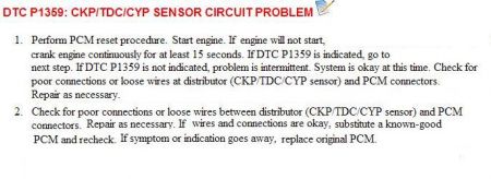

,.I already know whats wrong with it,.,.
,all I want to know is ,.,.how am I gonna get the procedures to fix the problem of my car??
.,the datalink device show,me.,whats the problem,.,and I already got the codes/.It was P1359.,./so I just need the procedures.,.,

Sounds like you just need a new distributor..details about the DTC are below..
