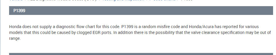

car started sputtering... not having power when i pressed on the gas. worse when i step hard or fast. have to back off the gas then procede. finally after months of this if threw the p1399 code. changed the cap and rotor, dind't fix.... changed the fuel pump.. still didn't fix. anyone ever been thru this for honda before.... strange stuff help please!

P1399 is a temporary code for misfiring.
Did you check the spark plugs and wires? Could be a failing ignition coil.
Was any other codes retrieved?
Another item to check would be a lazy O2 sensor. Get the freeze data if possible.

Temporary means it is not a confirmed. It takes a two trip fault, ie the fault must occur 2 times before the the actual misfiring code would be detected.
I have encountered a few cases of the symptoms decribed which were caused by a lazy ( faulty ) O2 sensor. Some scanners were not able to detect the problem so you might need to use a different scanner to see if it shows anything.

P1399 on a 99' CRV? The B20 engines in the 1997-2001 CR-Vs are known to have problems with valves tightening and then 'burning'
The Cam profiles don't let the exhaust valves enough time to cool. So it leads to them cooking.
Have valves adjusted LOOSE and inspect for damage.

If it is an O2 sensor problem, it usually is a fault with the primary HO2S, the one located before the catalytic converter.
Is the engine idling smoothly? If not, then as ej00807 mentioned, get the valve clearances adjusted.

The trouble code is coming up po302 and p1399
The first code is easy misfire #2 cylinder the second code is non specific for the honda listing, The OBD II scanner says ignition control, manufacture pending, does this mean honda is waiting to update their code list? I called the dealer they claimed no description of that codeis listed yet the OBD II scanner says there is , could you help?

P1399 = Random Misfire. This is usually associated with other misfire codes such as P0300, P0301, P0302, P0303 etc.......................................................................
Dec 9, 2020 at 12:53 AM (Merged)
Correct the P1399 is just stating that there are misfires on various cylinders. We need to diagnose the other misfires and this will just go away.
If you have a misfire on cylinder 2 then just address that and this other will go away.
Here is a guide that will help with this.
Just make sure you check compression as well as this can cause misfires and most overlook this.
