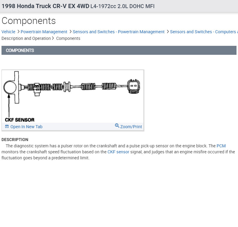

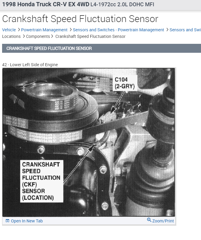

It sounds like an issue with the crankshaft speed fluctuation sensor.
With the heat and vibration from the engine that sensor can loses its calibration and send error signal to the ECM. And that triggers an engine shut down. It can happen regardless of if the vehicle is in motion or stationery.
That sensor is located on the lower part of the engine, next to the crankshaft pulley (see picture below).
