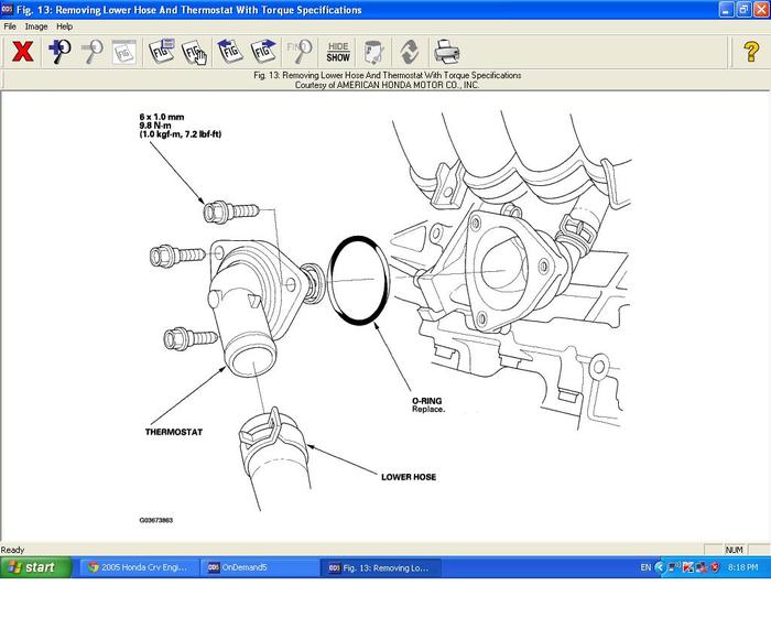

Hello, the thermostat is located under the front of the intake inlet by the boot near the top of the transmission. Here is a picture for what it looks like to help you locate it.
https://images.2carpros.com/forum/automotive_pictures/12900_thermos_1.jpg
Also here is guide to help you change it. https://www.2carpros.com/articles/replace-thermostat Please let me know if you need anything else to get the problem fixed. Best, Ken

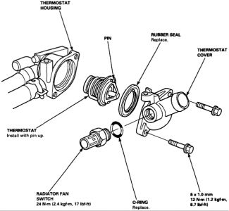

Can anyone tell me where is the thermostat located on this 2 litre 2 wheel drive petrol CRV and how to change it? The temperature gauge always seems to be low, so I suspect the thermostat is faulty. thanks
Mar 13, 2017 at 6:23 AM (Merged)
FAKHIR
  • 26 POSTS

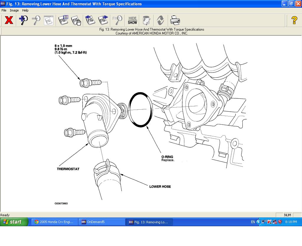

hope it will help you.
HMAC300
  • 48,601 POSTS
chart is correct
