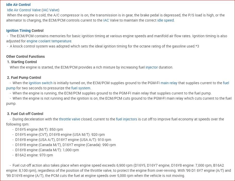

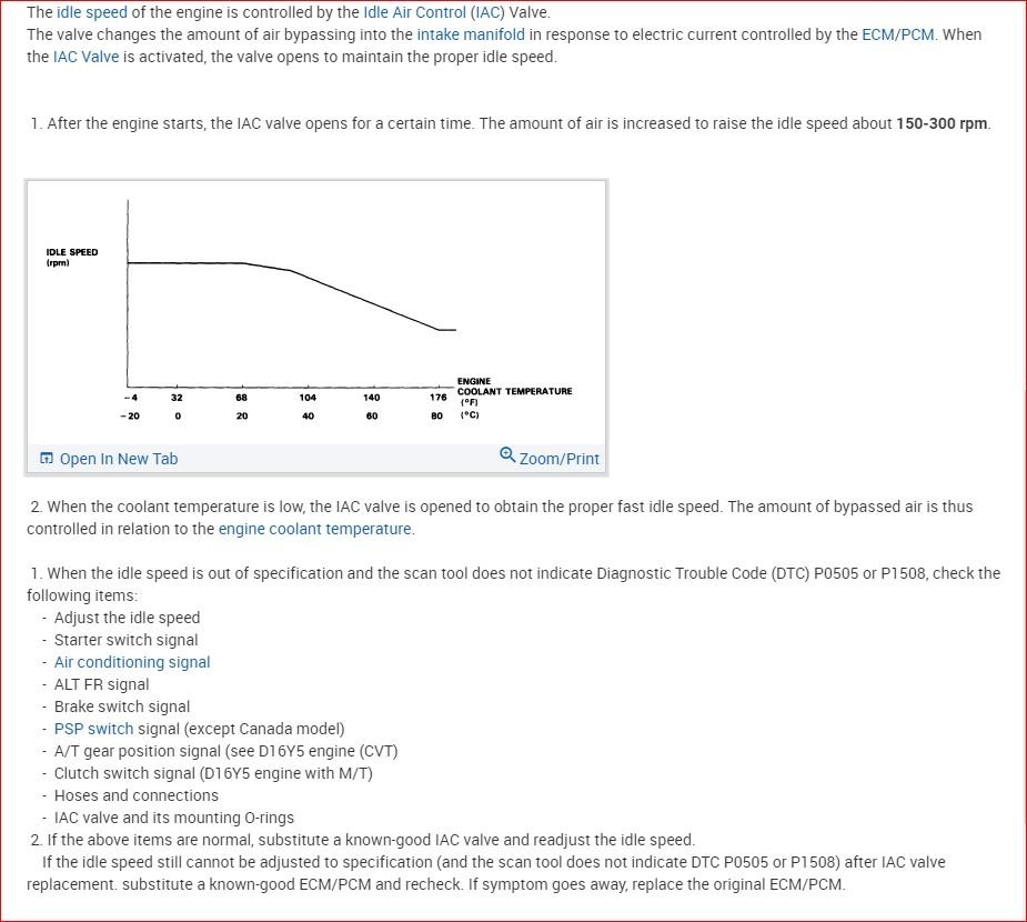

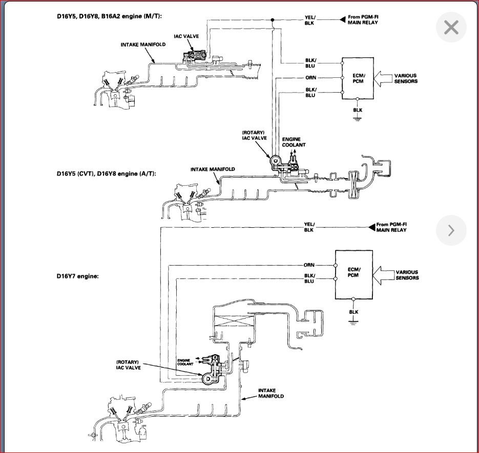

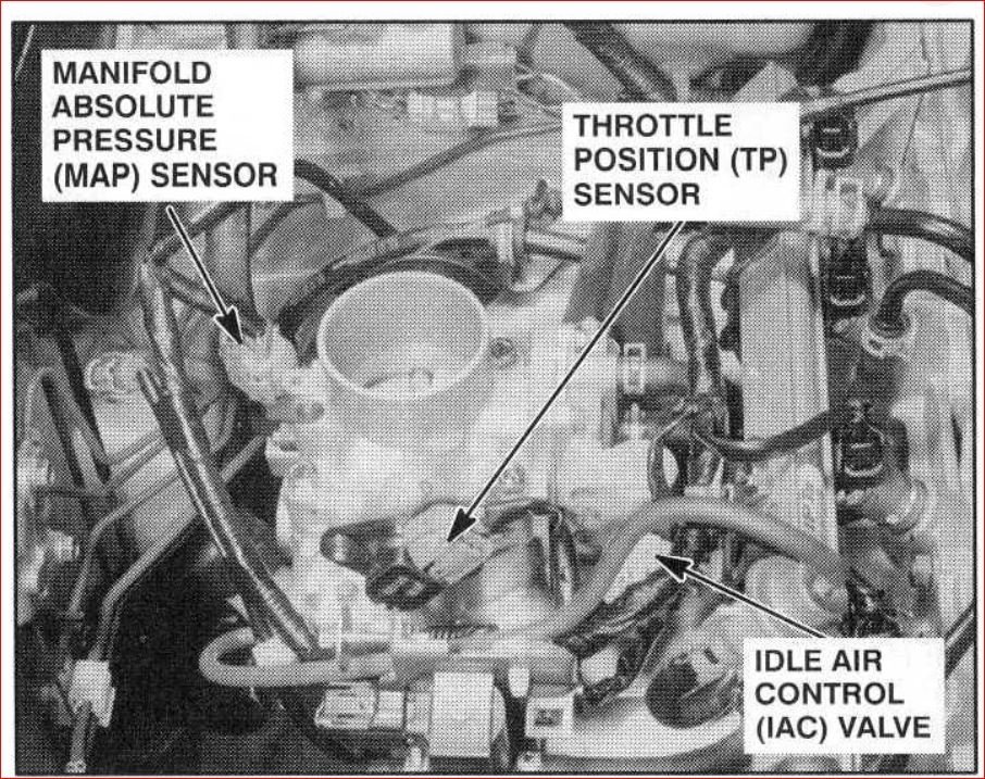

If this is only occurring during idle at cold start, then there is a good chance that it is the idle air control valve. The IAC is PCM controlled and regulates the air going into the engine during idle. If you take off immediately and it does not do this, then that would support this theory. These are easily cleaned. Just remove it and clean it out with carb cleaner.
