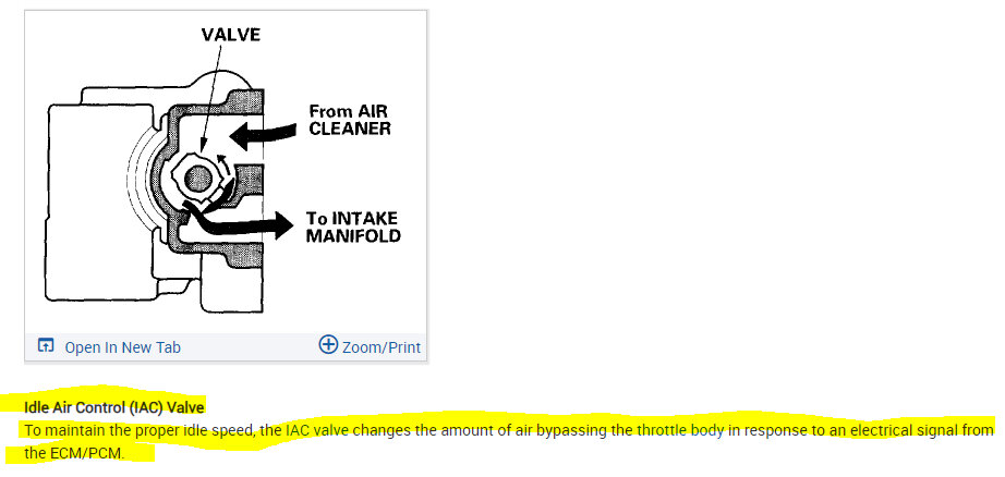

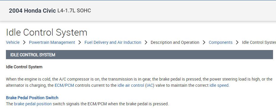

I totally understand why you always have it on. LOL There is an idle air control valve (IAC) on this vehicle. When everything is off with the engine running, it allows so much air to enter the combustion chamber to keep it at a steady idle. However, when you place a load on the engine such as the AC, the IAC then is signaled by the PCM to open more to increase the idle speed to compensate.
I attached a couple of pictures below that better explain. Also, here are two links that explain in general how one works and is serviced:

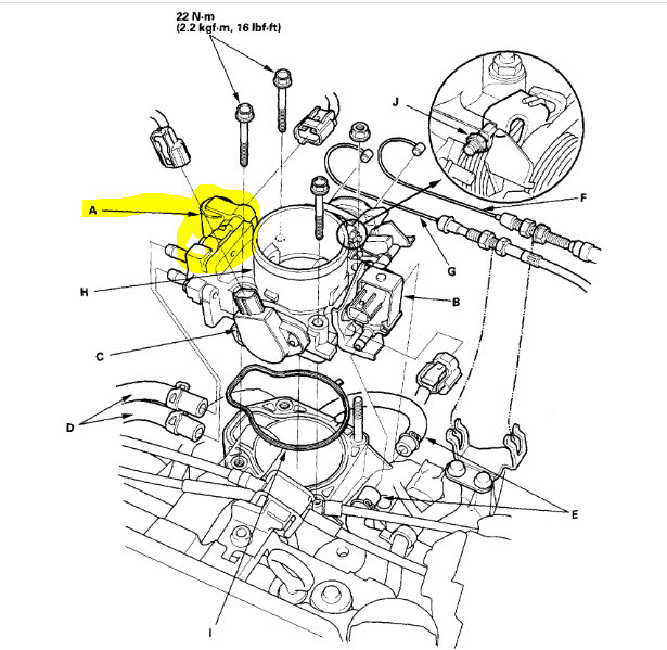

If that resolved the stalling issue, we may need to replace the idle air control valve or try to service it. I attached general directions above for you. If you look below, I attached a picture showing its location.
If you remove the IAC, make sure there is no carbon where it mounts onto the throttle body.
See pic below.
Oct 8, 2024 at 12:08 PM
