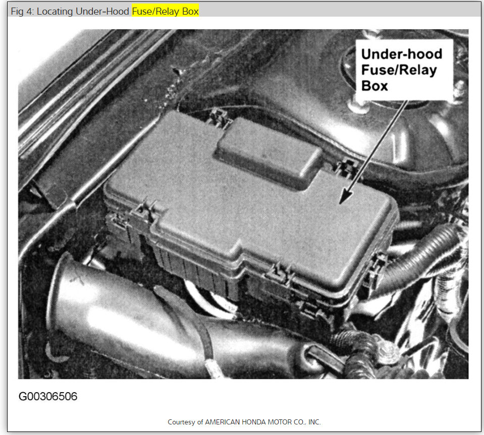

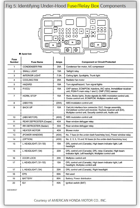

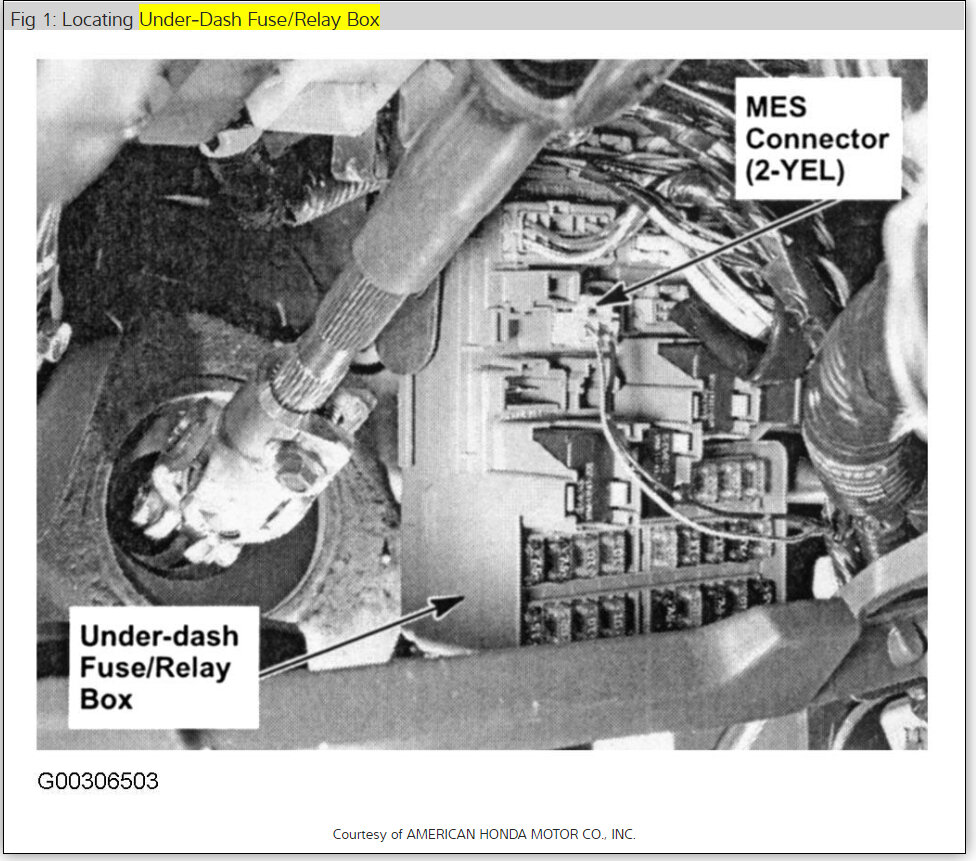

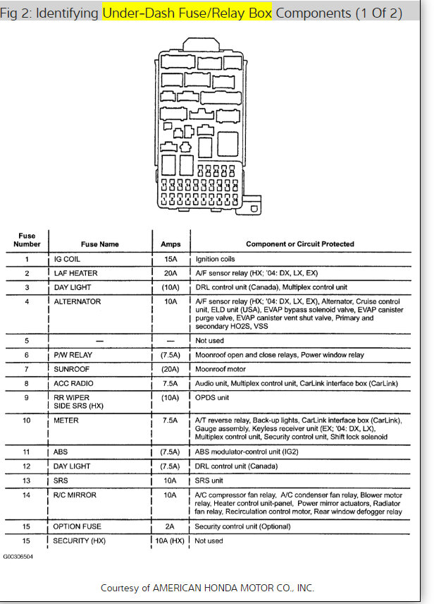

It sounds like the PCM is not working but we should check the fuses first. I would start with the #9 fuse under the hood because that is what powers the ALDL connector. I have seen the Multiplex control unit go out and cause all kinds of weird problems but let's do step 1 first.
Here is a guide to help with the fuse locations in the images below to help you with the test:
Also, if you could upload a short video of the engine cranking over, I can tell if the engine is in good shape. Please let me know what you find.
Feb 19, 2023 at 2:43 AM
TRIPWIRE
Okay, so, the number 9 fuse is good. Here is a video of it running.

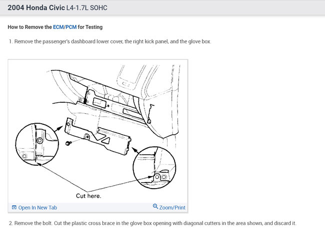

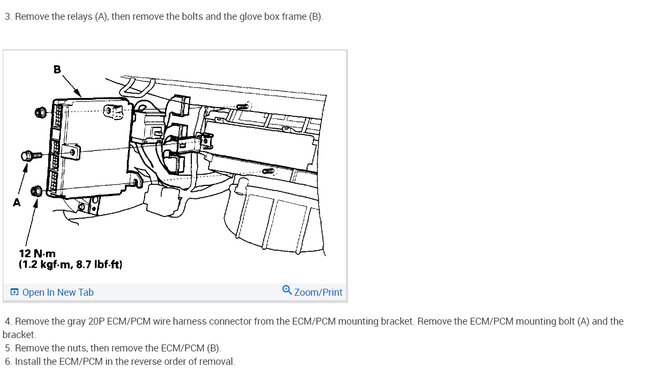

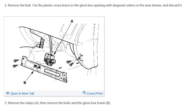

Thanks for the video. The fact that the engine is hard starting is telling me the throttle body and IAC valve needs to be serviced and this will cause the car to go into limp mode. Please check out these two guides and the images below to show you how to service the throttle bore on your car:
and
https://www.2carpros.com/articles/reduced-power-limp-mode
You could have an ECM that is out which is why the scanner will not communicate. Here is the location of the ECM so you can get a rebuilt unit by searching Ebay or Google.
