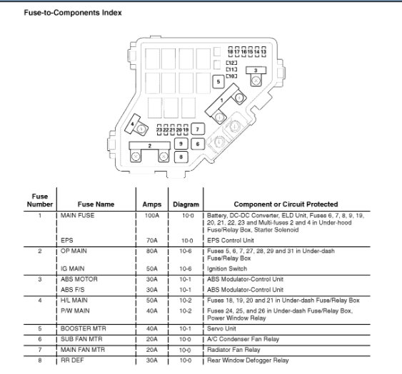

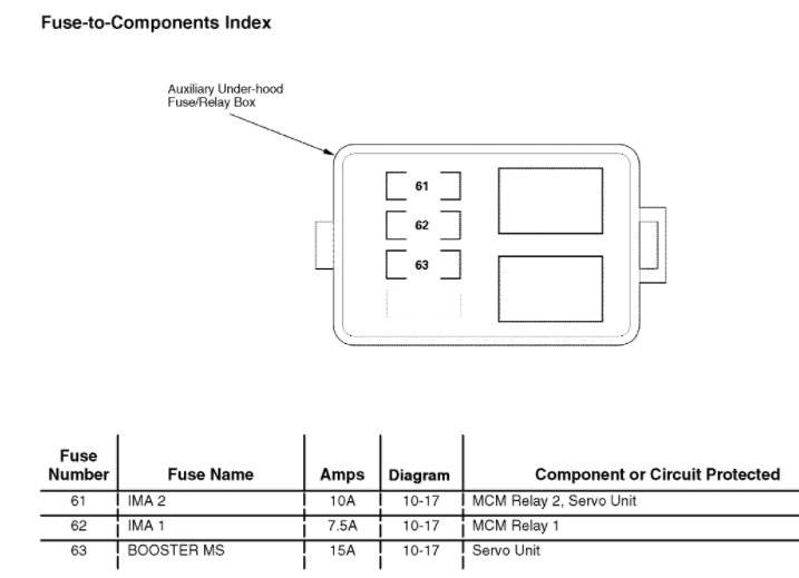

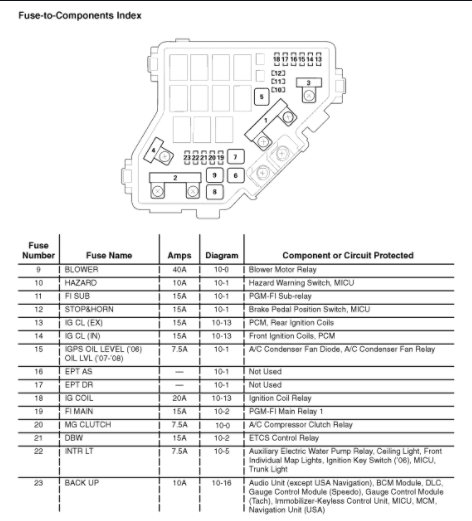

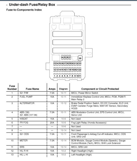

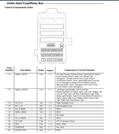

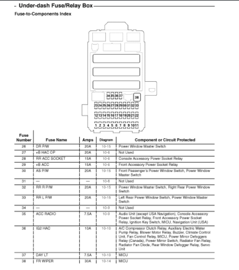

ABS system is fail read code is"power supply is fail." Please help me heck the fuses where are they?
Aug 8, 2009 at 10:16 AM
DANNY L
  • 5,648 POSTS
Hello, I'm Danny.
Here is the information you requested. Here are a few tutorials for you to view on how to check and replace fuses:
I've attached pictures below showing the fuse and relay locations on your car. Hope this helps and thanks for using 2CarPros.
