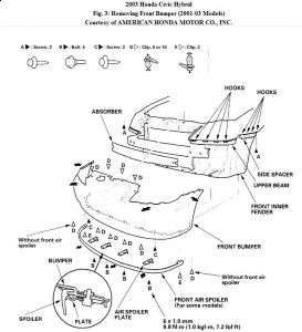

Where are the clips located for the front bumber. I'll try to check it out on my own, didn't know it was that easy, thanks.
Oct 21, 2009 at 10:18 AM
KHLOW2008
  • 41,814 POSTS
Here is a diagram of the bumper and clips.
https://images.2carpros.com/forum/automotive_pictures/192750_BumperFrt03CivicHybridFig03_1.jpg
Oct 21, 2009 at 11:56 PM
SEBKEEFE
Well, I've gone ahead and removed the front bumber cover - then it was as easy as pie to put in the new horn. Thanks a lot for your time and knowledge, works great now.
