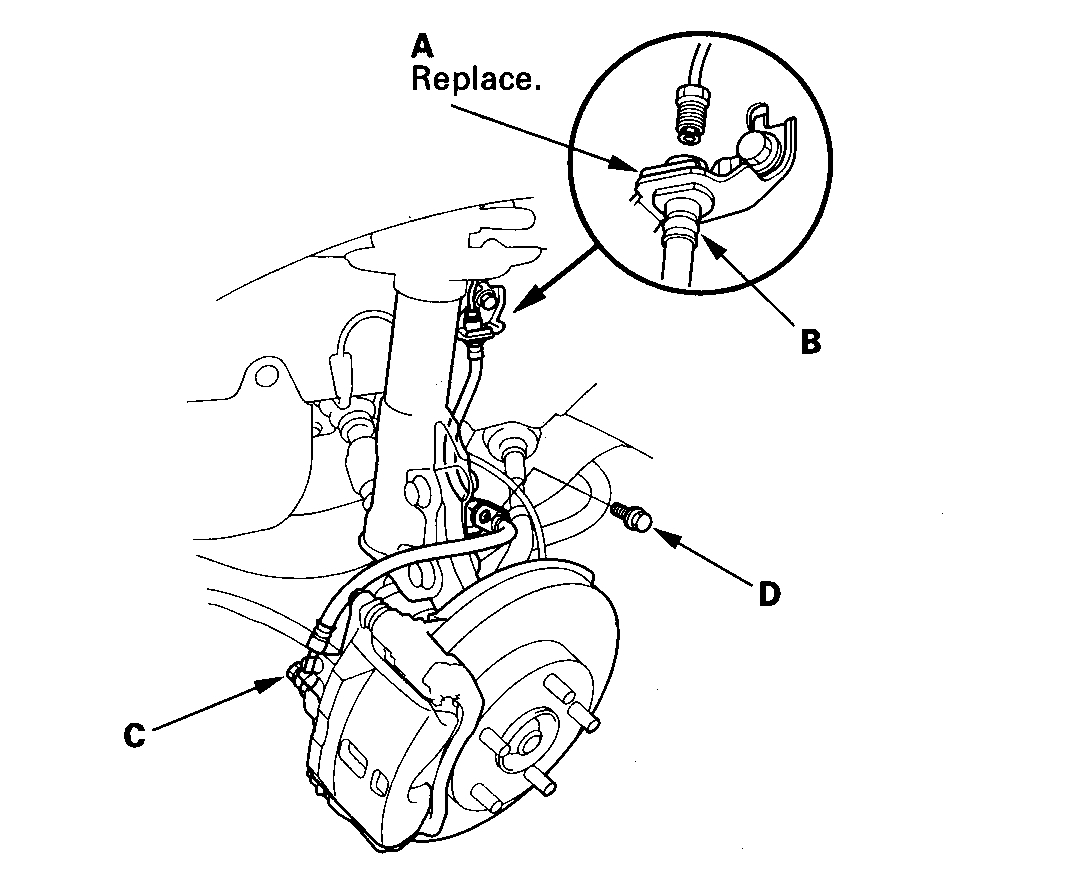

Hi, I have a problem with my car. It leaks brake fluid from the right front brake hose.
Wednesday, July 2nd, 2008 AT 10:26 AM
  • 109,896 POSTS
When the hoses get older, they can dry rot and crack creating a leak. This can cause brake failure if the hose totally breaks.
Here are the directions specific to your vehicle for replacement. The attached pics correlate with the directions.

1. Remove the wheel.

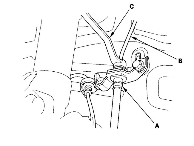

2. Disconnect the brake hose (A) from the brake line (B) using a 10 mm flare-nut wrench (C).
Pic 1

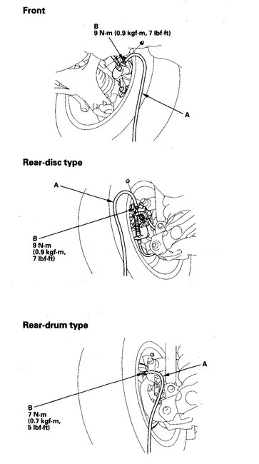

3. With clip type: Remove the brake hose clip (A) from the brake hose (B).
Pic 2

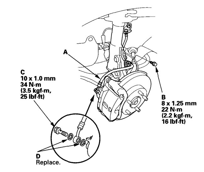

4. Disc brake type: Remove the banjo bolt (C), and disconnect the brake hose from the caliper.
5. Remove the brake hose mounting bolt(s) (D), then remove the brake hose.
NOTE: Without clip type: Remove the brake hose with the bracket.

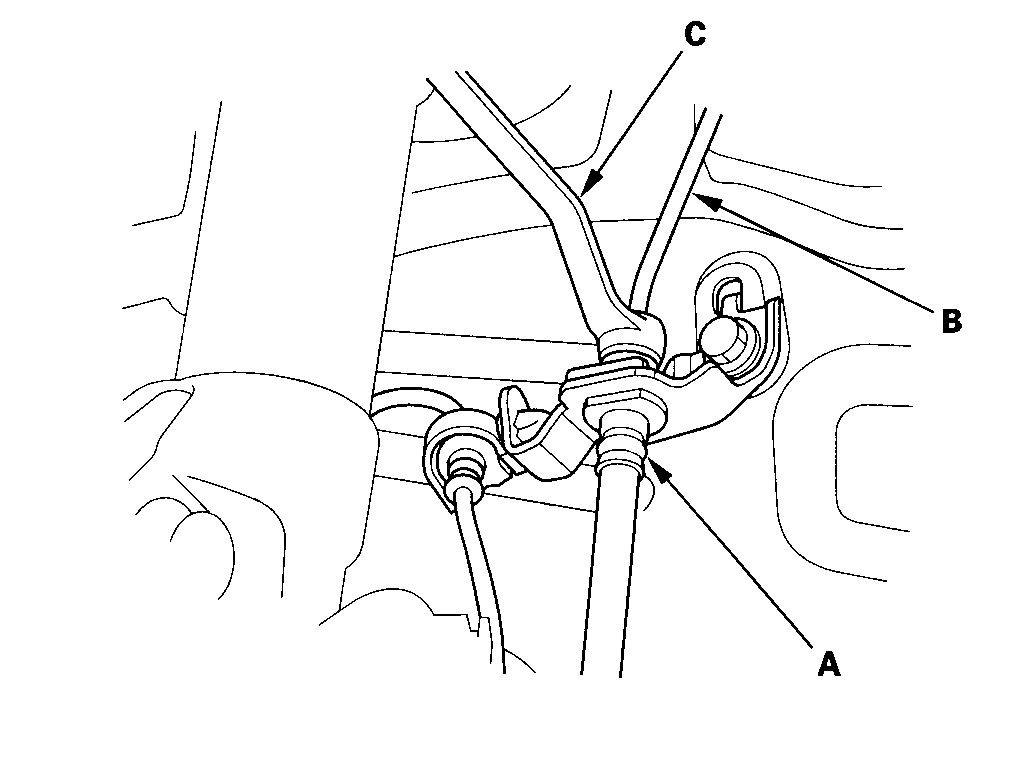

6. Install the brake hose (A) with the brake hose mounting bolt (B).
Pic 3
7. Disc brake type: Connect the brake hose to the caliper with the banjo bolt (C) and new sealing washers (D).

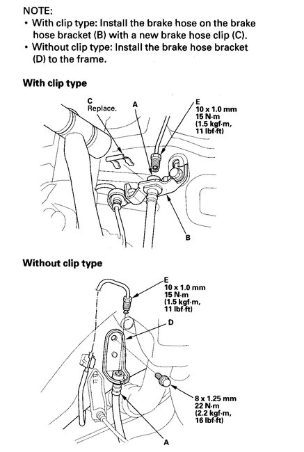

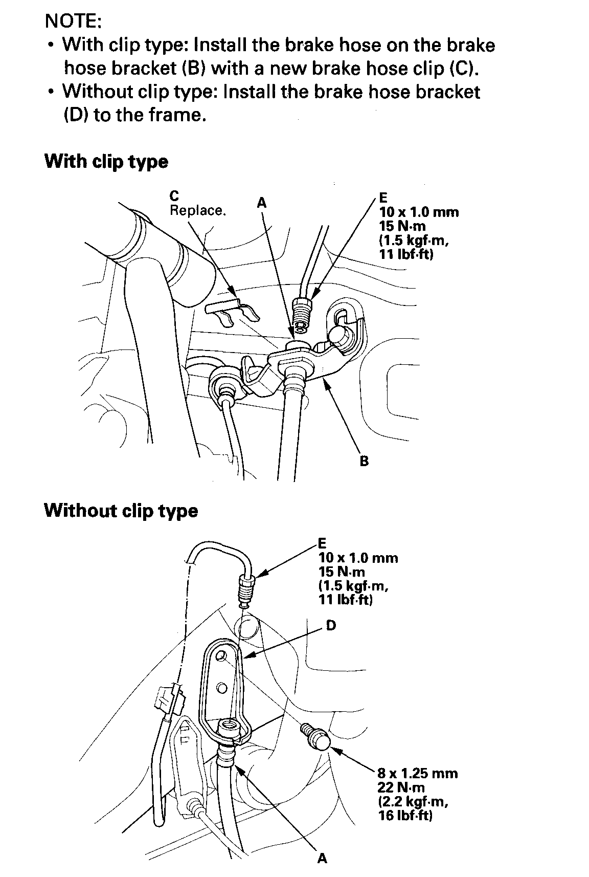

8. Position the brake hose ends (A).
NOTE:
With clip type: Install the brake hose on the brake hose bracket (B) with a new brake hose clip (C).
Without clip type: Install the brake hose bracket (D) to the frame.
Pic 4
9. Connect the brake line (E) to the brake hose.

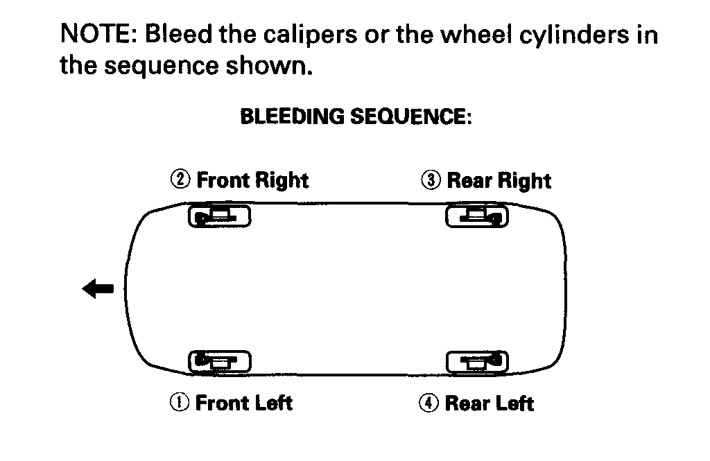

Here are the directions for bleeding. If you prevent the master cylinder from getting empty, you should be able to just bleed the brake with the new hose. If the master cylinder empties, bleed all brakes.

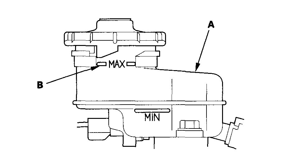

The reservoir connected to the master cylinder must be at the MAX (upper) level mark at the start of the bleeding procedure and checked after bleeding each brake system. Add fluid as required.
1. Make sure the brake fluid level in the reservoir (A) is at the MAX (upper) level line (B).

2. Have someone slowly pump the brake pedal several times, then apply steady pressure.

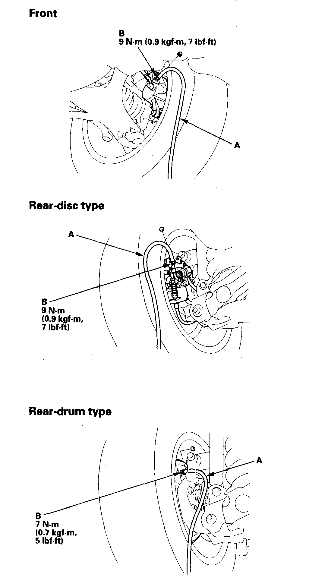

3. Start the bleeding at the driver's side of the front brake system.
Pic 6
4. Attach a length of clear drain tube (A) to the bleed screw (B), then, loosen the bleed screw to allow air to escape from the system. Then tighten the bleed screw securely.
Pic 7
5. Refill the master cylinder reservoir to the MAX (upper) level line.
6. Repeat the procedure for each brake circuit until no air bubbles are in the fluid.
