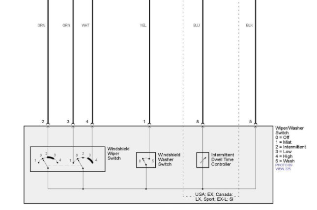

Bought my car a month ago..When I tested drive this car, after I pumped washer fluid and it did not stop squirting. It dribble when you drive and it stops when you stop the car. Dealer replaced motor week after bought the car. I pumped washer fluid and it will not stop spitting after washed. Any idea? Bad relay? I will disconnect battery and see if it stops spitting after reconnect the battery.
Mar 29, 2010 at 11:36 PM
DANNY L
  • 5,648 POSTS
Hello, I'm Danny.

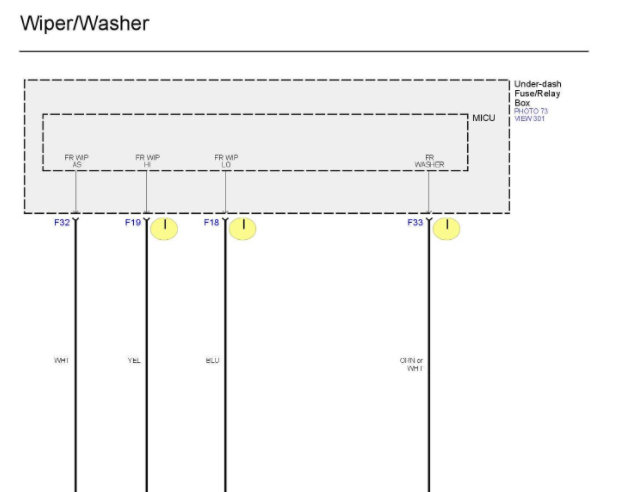

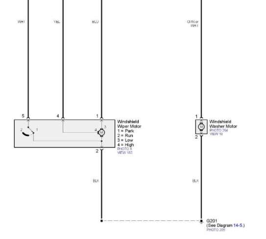

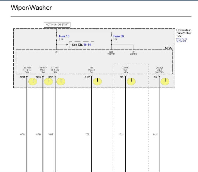

Here is the information you requested. This issue could be caused by an electrical or relay that is shorted to ground causing the washer pump to have voltage and continue to dribble after use. Here is a tutorial showing how to test electrical circuits:
I've attached the wiper motor wiring circuit for your car. Hope this helps and thanks for using 2CarPros.
