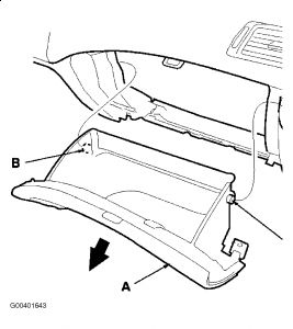

How do I find the cabin air filter and replace it?
Thank you!
Apr 14, 2009 at 1:00 PM
BMRFIXIT
  • 19,053 POSTS
CABIN AIR FILTER Removal & Installation Open the glove box. Remove the glove box stop (B) on each side, then let the glove box hang down. See Fig. 1.

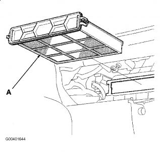

Remove the dust and pollen filter assembly (A) from the evaporator. See Fig. 2.

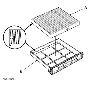

Remove the filter (A) from the housing (B), and replace the filter. Install the filter in the reverse order of removal. Make sure that there is no air leaking out of the evaporator. Fig. 3:
https://images.2carpros.com/forum/automotive_pictures/99387_Graphic3_66.jpg
If there was a maintenance reminder to replace the dust and pollen filter, reset the maintenance reminder, and this procedure is complete. Maintenance reminder can be reset using a factory scan tool, or equivalent aftermarket scan tool.
