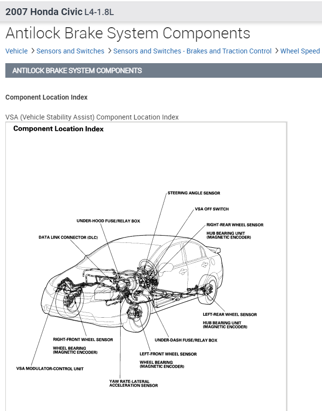

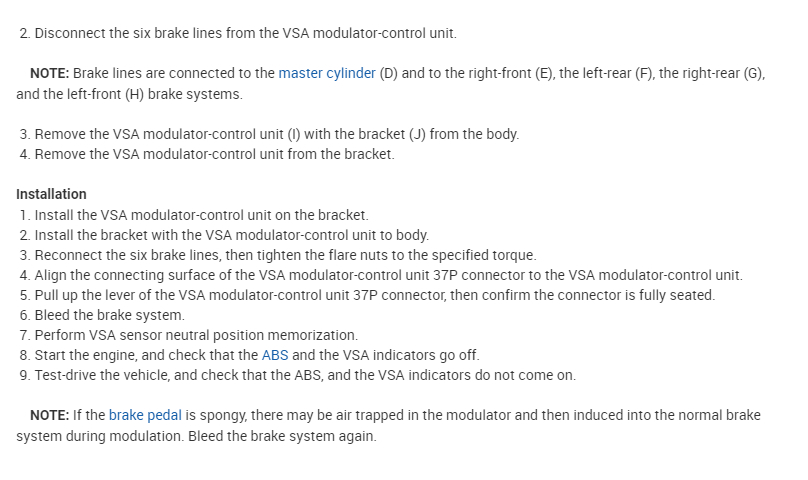

My daughter drives this car in the Los Angeles area. I know that they have a lot of stop and go traffic, but this seems like the ABS kicks in at slow speeds can you help me fix it?
Sep 23, 2008 at 8:34 PM
SQM
  • 6,383 POSTS

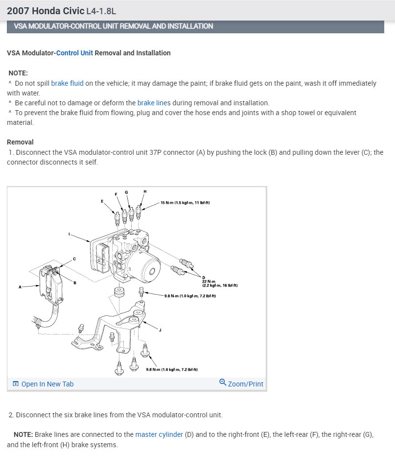

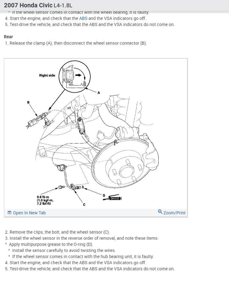

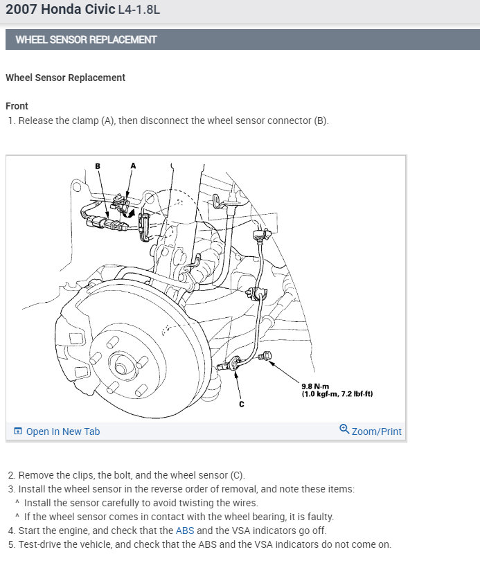

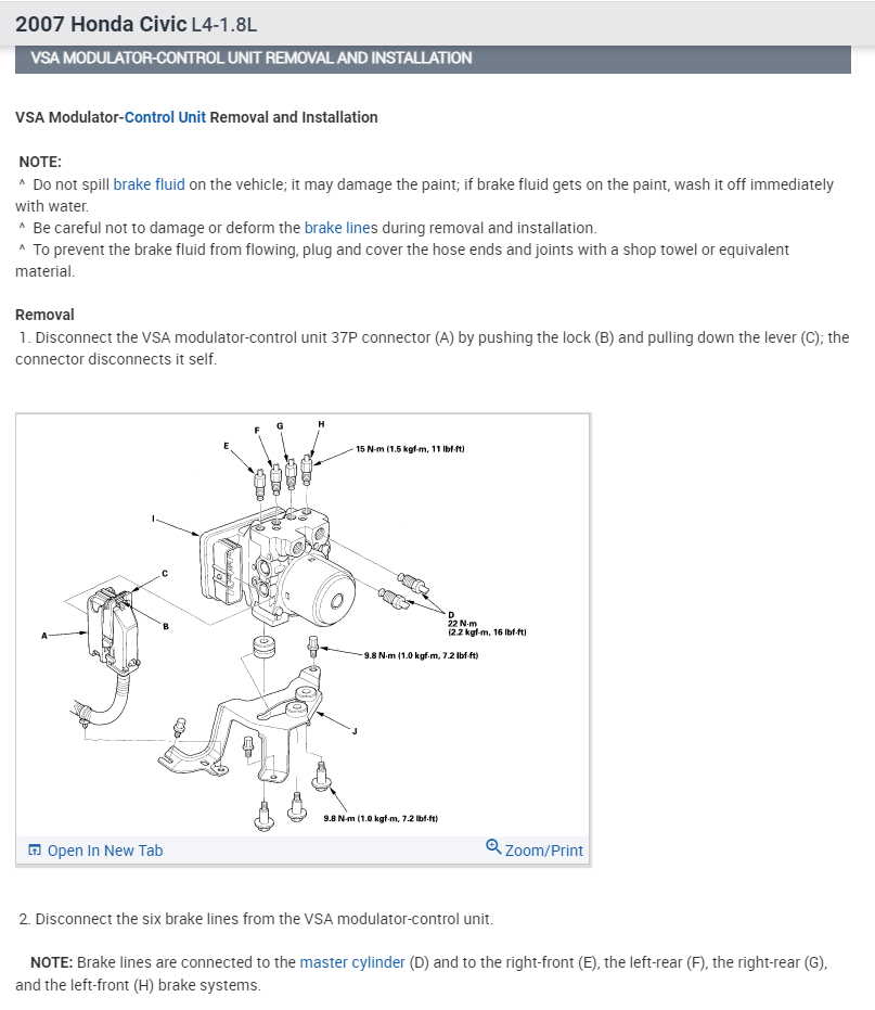

If the ABS kicks in or the light flashes randomly, it could be due to an issue within the ABS system. This could be issue with the module or a sensor that is sending error signal to the module and the module triggering the ABS system.
First check to see if the ABS light is illuminated. The light gets triggered when the on-board diagnostics detects any error within the ABS system.
Scan the vehicle and retrieve the ABS code(s). As that can help with the diagnostics.
