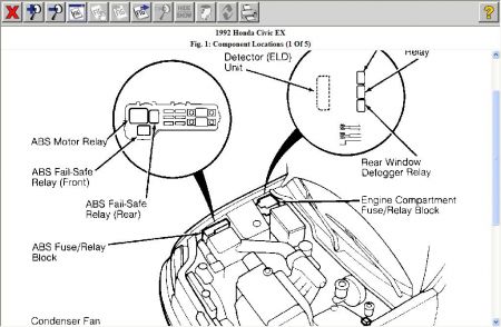

Where is the fail safe relay located and what effect does it have on Abs system?

Hi susumu, The failsafe relays are located in the ABS fuse box.
https://images.2carpros.com/forum/automotive_pictures/192750_FailSafe92CivicMitchell_1.jpg
Fail-Safe Function When an abnormality is detected in the main system, solenoid valve operation is turned off by fail -safe relay. Under these conditions, the ABS system operates as a conventional brake system. The fail-safe function comes on with ABS warning light.

thank you, this a big help and the picture is a plus
