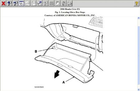

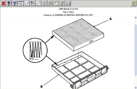

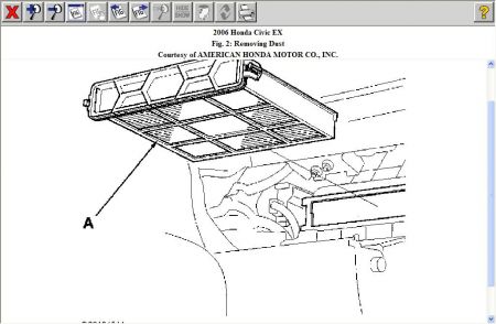

How to replace the pollen filter n a honda civic 2006.

Hi allouchi,
https://images.2carpros.com/forum/automotive_pictures/192750_CabinFilter06Civic01_1.jpg
https://images.2carpros.com/forum/automotive_pictures/192750_CabinFilter06Civic02_1.jpg
https://images.2carpros.com/forum/automotive_pictures/192750_CabinFilter06Civic03_1.jpg
