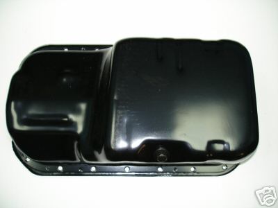

We want to do our oil change. Where is the oil drain plug and filter located on the engine?

Congrats on doing your oil on your own! It will save you time and money in the long run! You can't miss the oil pan. Jack up the front of the car and about about 2-3ft from the front you will see a black pan (oil pan) with a single bolt (17mm) facing backwards.
https://images.2carpros.com/forum/automotive_pictures/406903_SSyE_1.jpg
This is the best picture I could find :). It may not be exact, but very similar. If you click the link below, and watch the 1st video. It will give you a good idea as to what to do and look for. https://www.2carpros.com/car_sounds/clicking.htm
