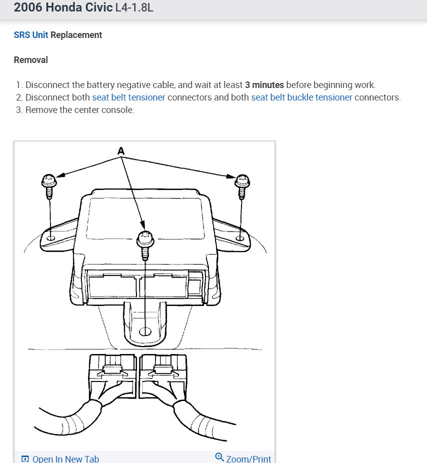

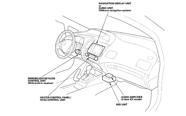

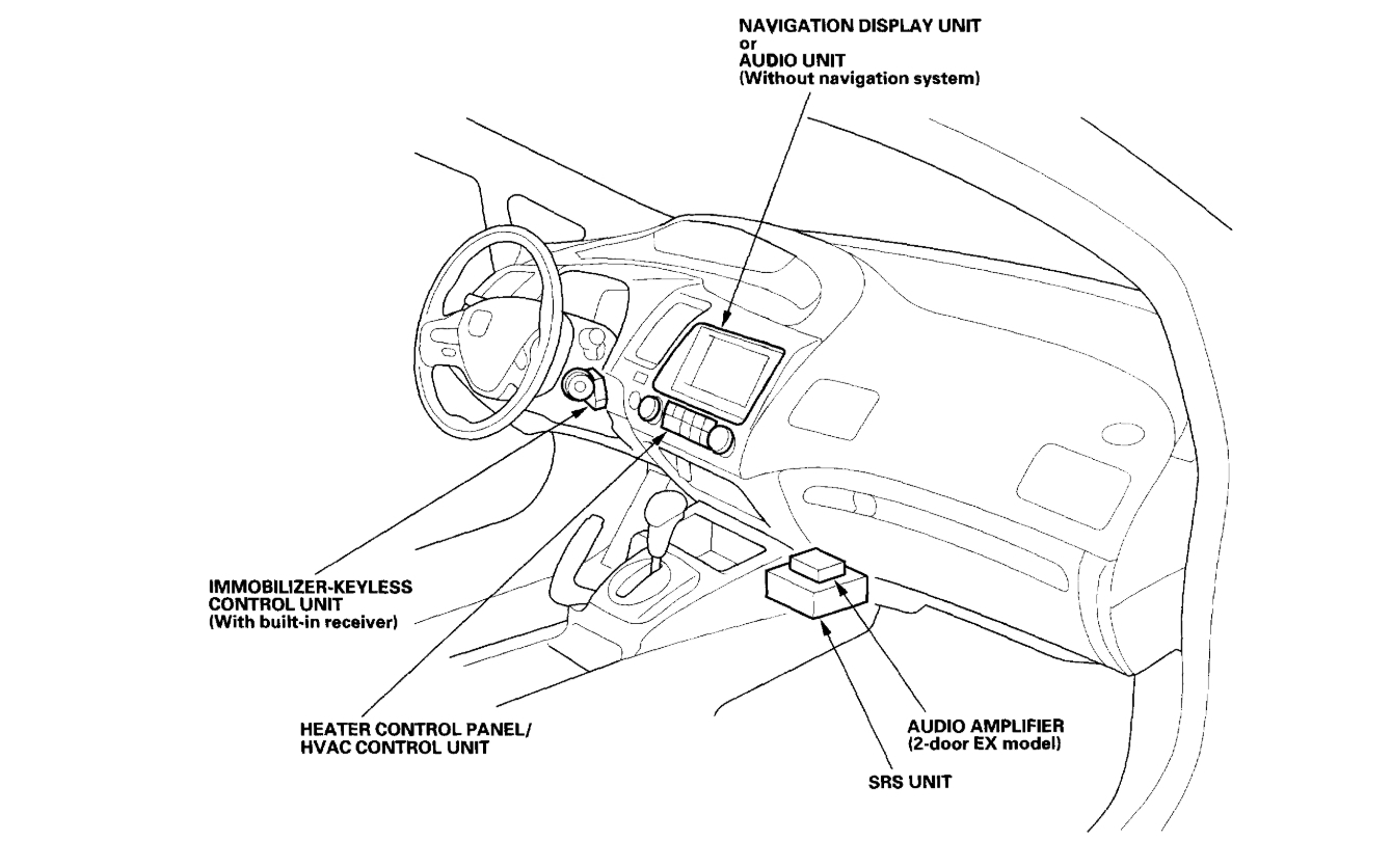

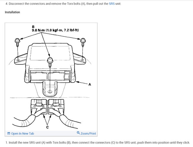

I would like to know where the airbag module is located on this car? also, if possible, how to take it out.
thanks
Dec 15, 2009 at 4:33 PM
KHLOW2008
  • 41,814 POSTS
Hi vitaliy2008,
Here is a diagram of the location. SRS unit in diagram, under the center of dash. Disconnect battery terminals for at least 10 minutes before attempting to dis any wire connectors. Check out the diagrams (Below). Please let us know if you need anything else to get the problem fixed.
