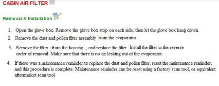

how do I change the airvent filter

https://images.2carpros.com/forum/automotive_pictures/261618_Noname_1394.jpg
