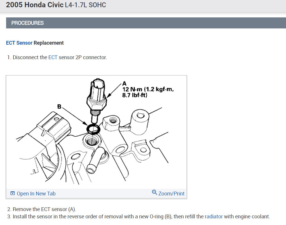

Temp needle will not move? What is the cause of this?

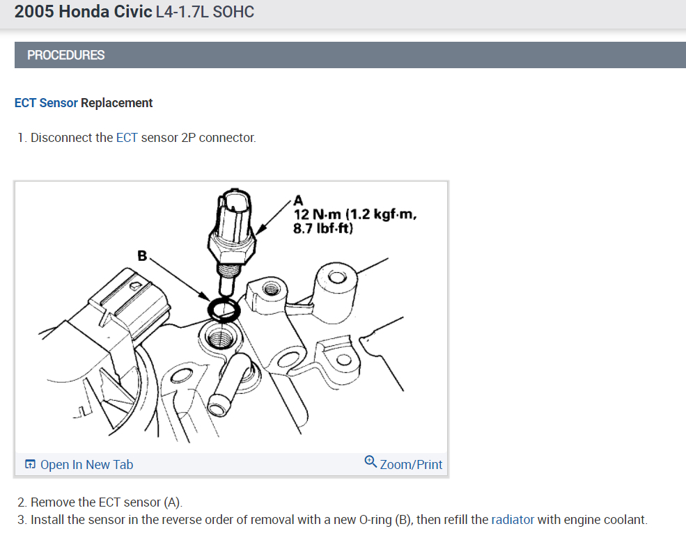

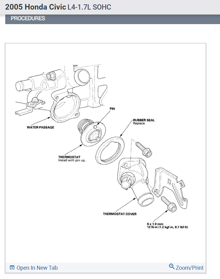

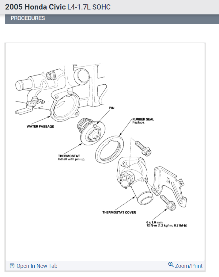

This could be a stuck thermostat or the engine temperature sensor needs to be replaced. Here is a guide to help you step by step with instructions in the diagrams below to show you how on your car.
Check out the diagrams (Below). Let us know what happens and please upload pictures or videos of the problem.
