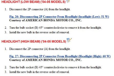

How do you replace the front bulb? Does it need to be brought into the dealer?
