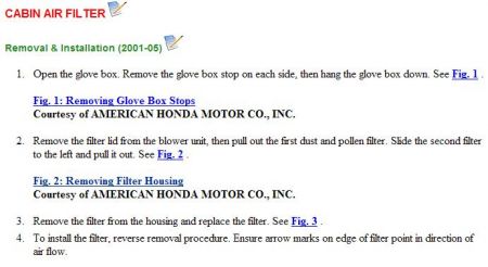

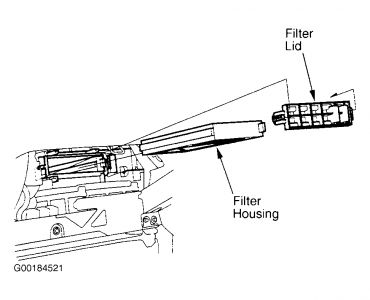

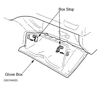

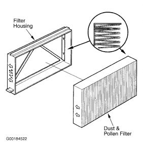

Where can you find the ac filter on 2005 civic and how do you change it?

The Cabin air filter is located behind the glove box, see pics for details.
