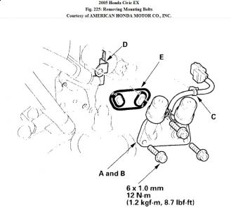

Seems the shift solenoids are not working correctly causing the harsh shifting. Did you check the fluid level and condition? When were the fluids last replaced? If you are into DIY, remove the shift solenoids to check for clogging and clean them and retest if problem improves or goes away.
https://images.2carpros.com/forum/automotive_pictures/192750_ShiftSoleanoid05CivicFig225_1.jpg
