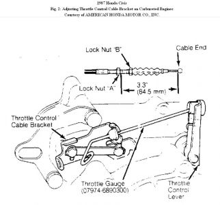

There is a specific way of doing it.
THROTTLE CONTROL CABLE BRACKET
Carbureted Engine Only
NOTE:
Use this procedure when to check throttle control cable bracket position.
1.Disconnect throttle control cable from throttle control lever. Bend down lock tabs of lock plate and remove two 6 mm bolts to free bracket.
2.Install a new lock plate. Position Throttle Gauge (07974-6890300) between throttle control lever and bracket. See Fig. 2 . Tool is designed so that distance between lever and bracket is 3.29" (83.5 mm) when tool is installed.
https://www.2carpros.com/forum/automotive_pictures/192750_ThrottleControlCable87CivicFig02_1.jpg
3.Position cable bracket so there is no binding between bracket and special tool. Tighten 6 mm bolts and bend up lock tabs against bolt heads. Adjust throttle control cable.
CAUTION:Make sure control lever is not pulled toward bracket side as bolts are tightened.
If you had not tampered with the bracket, DON'T. Remember to run the engine till operating temperature to allow the autochoke to open fully before performing the adjustment.
A weight has to be put on the pedal to eliminate the accelerator cable free play.
