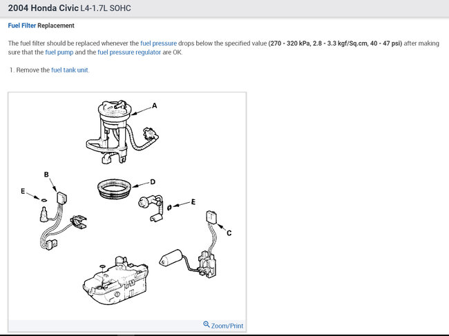

04 Civic SiR hatchback. I have been told that there is a lifetime fuel filter in the gas tank but also that there is another part in the engine bay, is this true and if so where is it? There is a metal cylinder on the firewall on the driver side but I don't know what it is. Any suggestions? Thanks.
Oct 16, 2008 at 7:44 AM
KHLOW2008
  • 41,814 POSTS
The fuel filter is in the fuel tank attached to the pump here is a guide to show you what it will take to remove the tank and pump assembly with diagrams below to show you on your car.
https://www.2carpros.com/articles/how-to-replace-an-electric-fuel-pump
Cheers

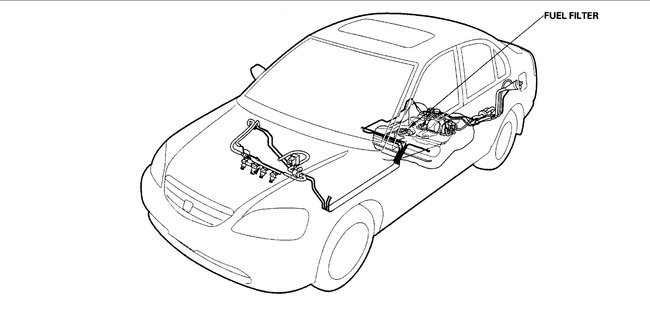

DAVE H
  • 13,384 POSTS
the fuel filter is part of the pump assembly located inside the fuel tank ..
https://images.2carpros.com/forum/automotive_pictures/266999_fuel_1.jpg

S.EMARD
Is there only one fuel filter on a 2003 honda civic
Aug 14, 2018 at 5:24 AM (Merged)
DAVE H
  • 13,384 POSTS
yes there is only one filter on the honda civic 2003 ..located on the fuel pump inside the tank

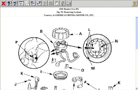

BROOKS948
Engine Mechanical problem
2001 Honda Civic 4 cyl Front Wheel Drive
Hi I'm trying to service a Honda Ciivic but i am having diificulty locating the fuel filter for this model. I have taken out the back seat and taken off the inspection cover, not there. I have dropped the fuel tank, not there. I have followed the fuel lines to the front of the car and look around even taking off the induction system but no luck. Where in the world have they put the fuel filter??????

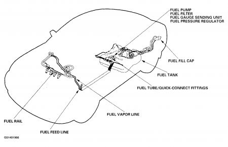

KHLOW2008
  • 41,814 POSTS
Hi brooks948, It is inside the fuel tank together with the fuel pump. Item B.
https://images.2carpros.com/forum/automotive_pictures/192750_FilterFuel01Civic_1.jpg
