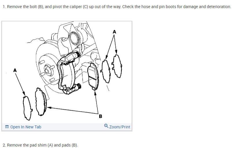

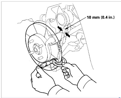

Please give me an idea. Everytime i started and move my car in the morning, it makes silly sound in the front.I guess it's the brakes. Waiting for your serious response. Thank you so much. Appreciated .
Apr 28, 2010 at 5:15 PM
DANNY L
  • 5,648 POSTS
Hello, I'm Danny.

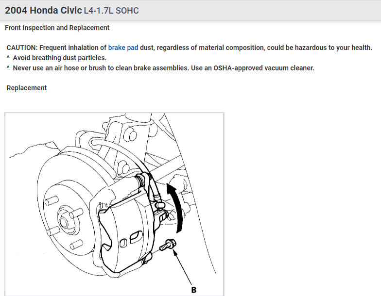

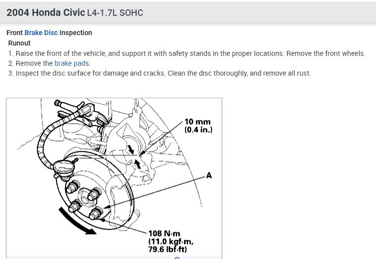

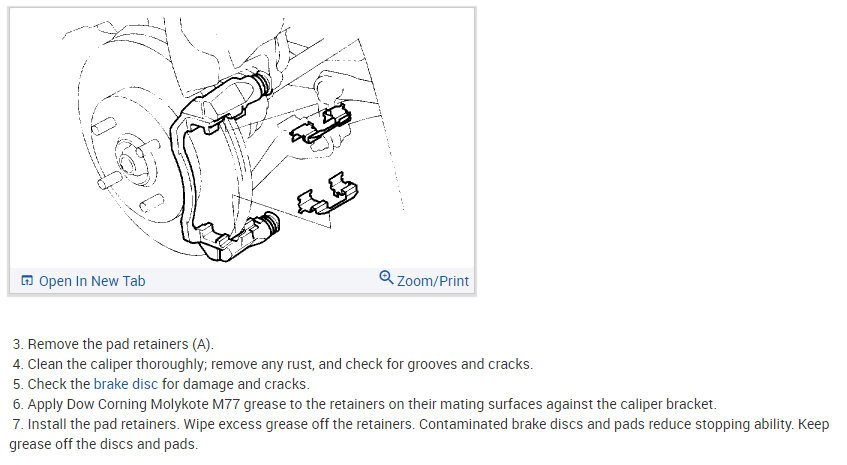

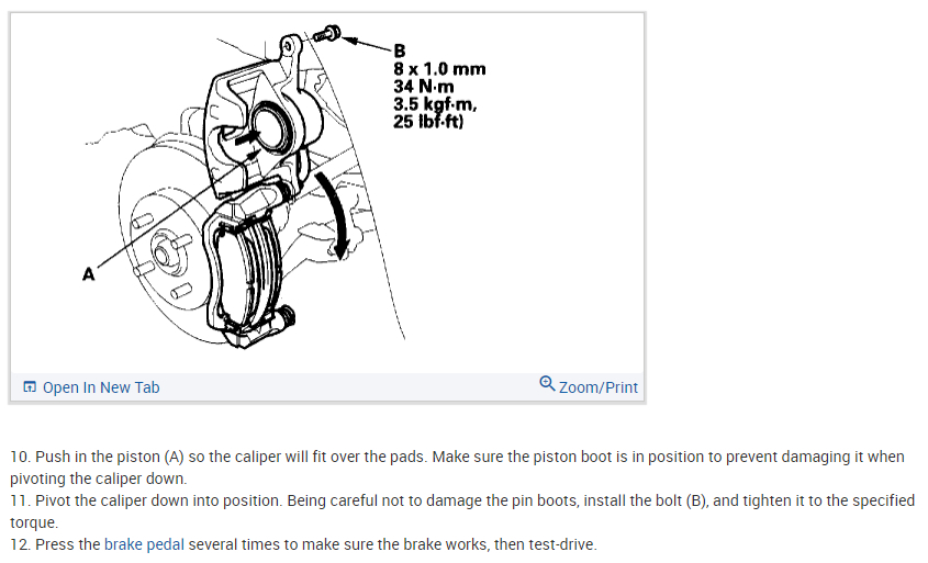

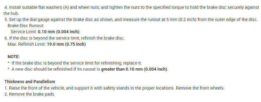

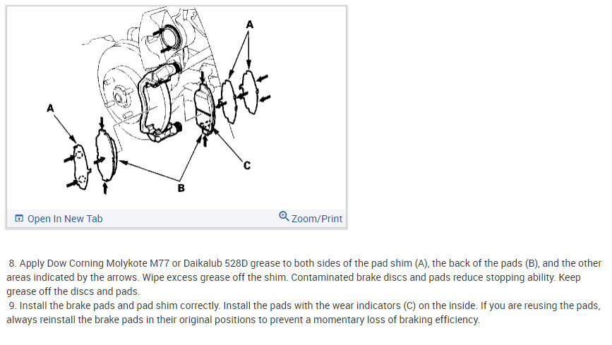

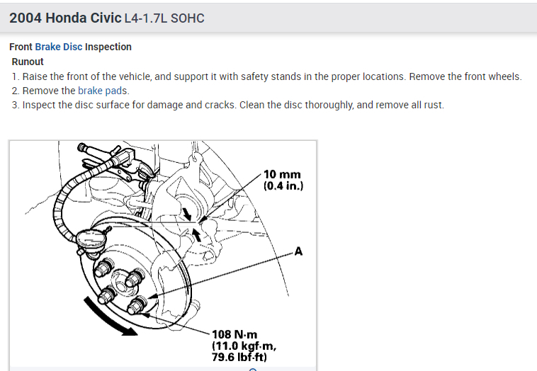

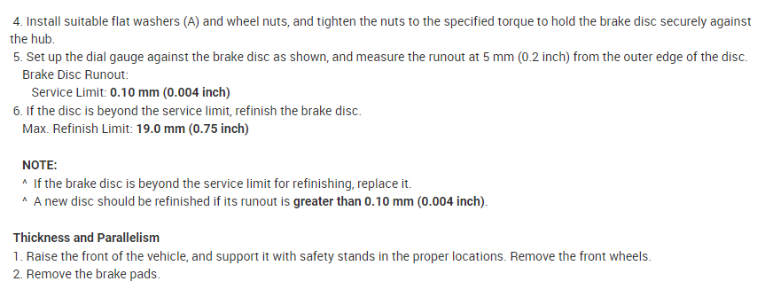

Here is a tutorial for you to view getting you started on how to change the front brake pads and rotors:
I've attached picture steps below on how to change the front brake pads and inspect the rotors on your vehicle. Hope this helps and thanks for using 2CarPros.
