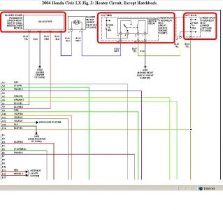

My daughter was driving the car and the blower/fan for the air/heat system inside just stopped working. Is this a fuse problem or something worse? It contiued producing heat but it was not blowing out since the fan/blower died.

Start by checking fuse #14 10 amps fuse box, under left side of dash. blower motor relay, relay box under the hood right side of engine compartment, and blower transistor under right side of dash, next to the blower motor.
https://www.2carpros.com/forum/automotive_pictures/55316_04civicheater_1.jpg
