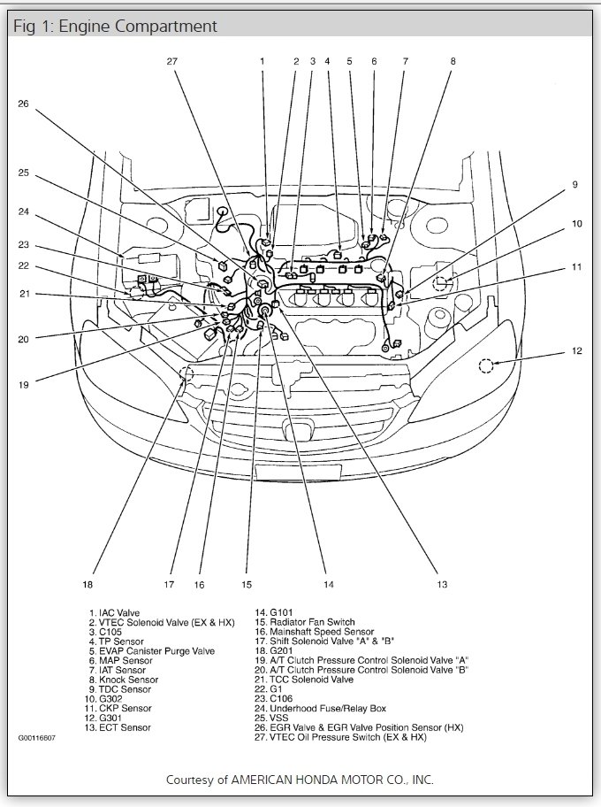

2003 Honda Civic Where is my MAP sensor?

I'm trying to find the MAP sensor on my 2003 Civic. I built a device to tune the mix in my enigne that works great in my Durango, but I can't find the sensor in my Honda. Thanks.

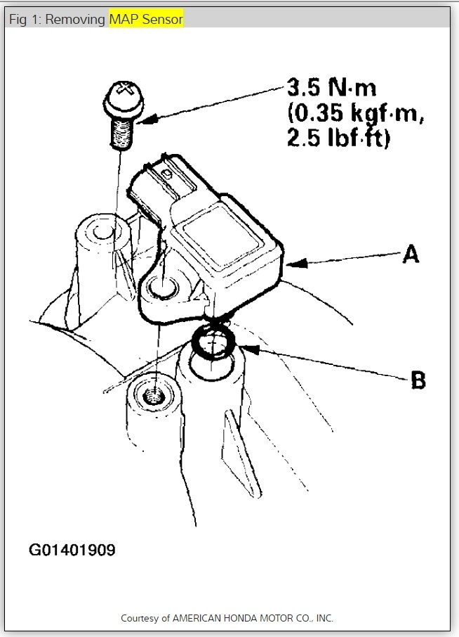

The map sensor is located in the intake manifold here are two diagrams I have found for you please look below,
Please let us know what you find so it will help others.
Best, Ken
