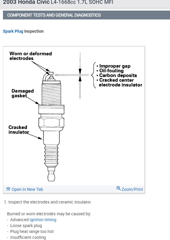

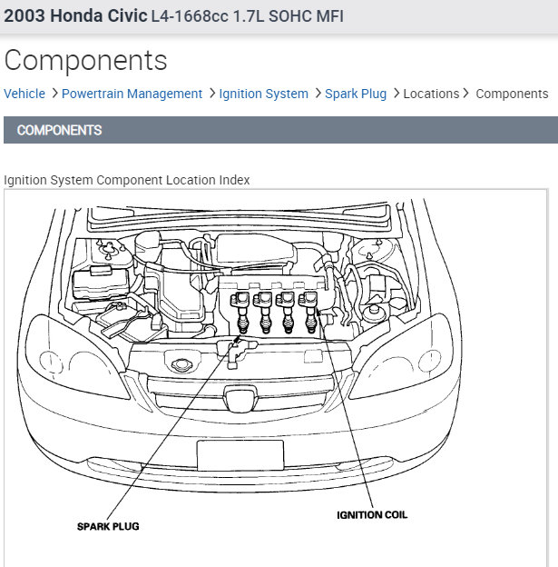

where are the plugs located on these engines?does it take wires or coils?
Nov 21, 2008 at 2:50 PM
SQM
  • 6,383 POSTS

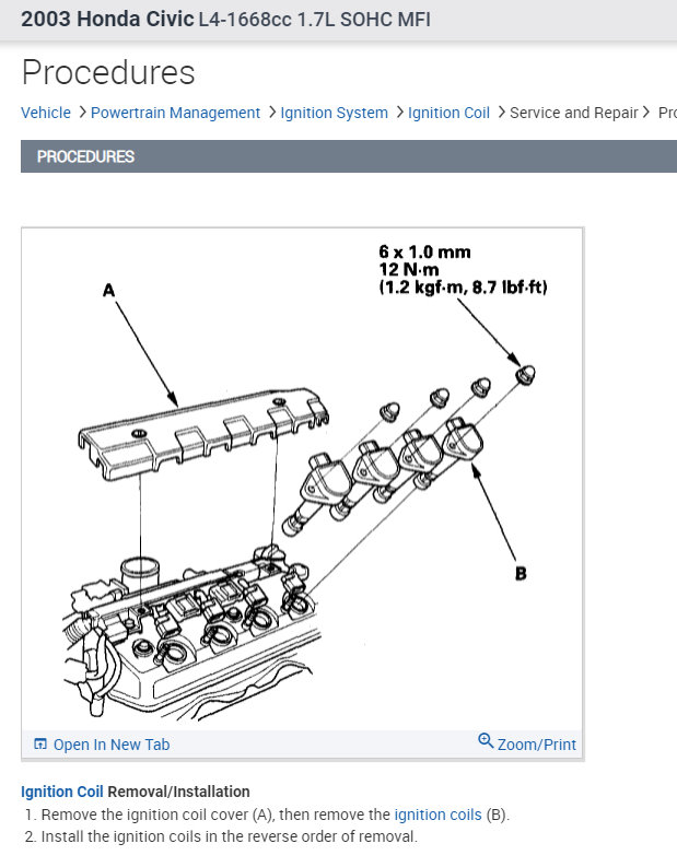

On this vehicle it has a coil for each plug (no wires).
The spark plugs and ignition coils can be accessed by removing a cover at the top of the engine.
https://www.2carpros.com/articles/how-to-change-spark-plugs

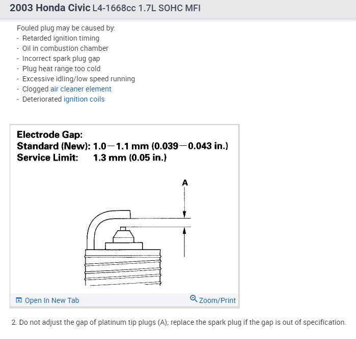

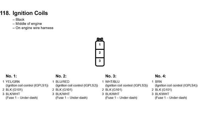

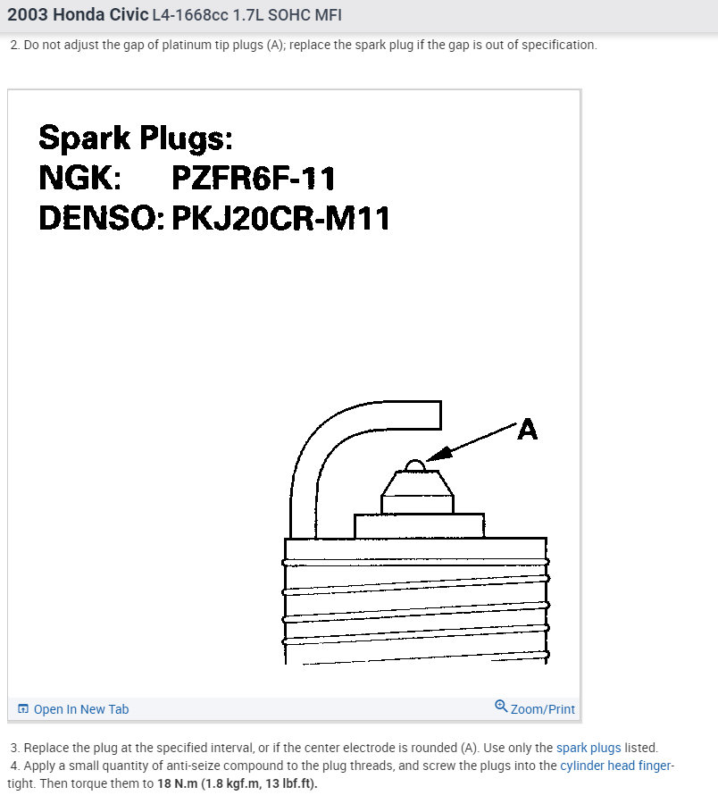

I have attached diagrams showing the locating and removal procedure.
