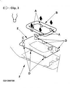

I have a miniature bulb burned out in my shif selector in the center console.
I have the bulb.
I need step by step to remove the console plastic parts to replace this bulb. Honda does not sell a repair manual.
And they are asking 1.5 hours labor to replace the bulb. Can you help me?

You may have to remove the shifter knob, should be a set screw on the front of it to release it.Then go by the pic to pop the trim pieces out to get to the shifter light. The pics I have arent very good, but its all I can find
