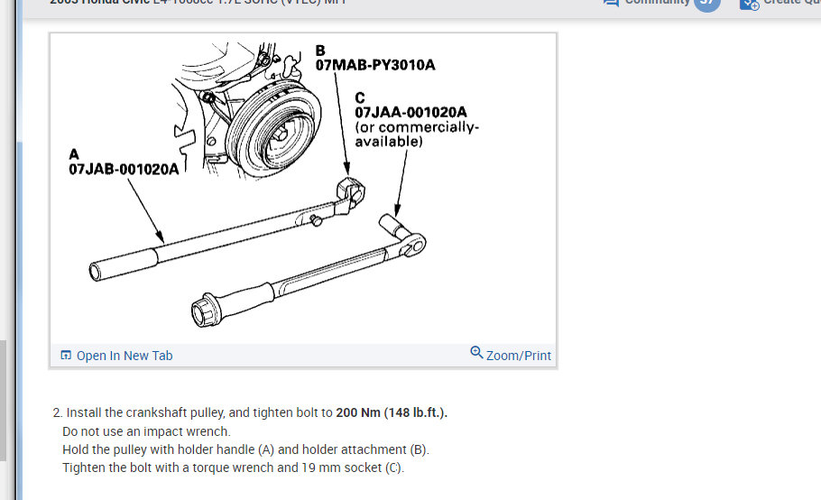

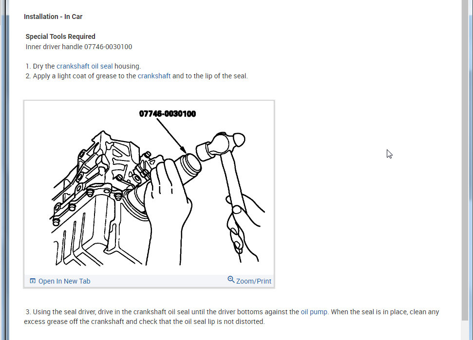

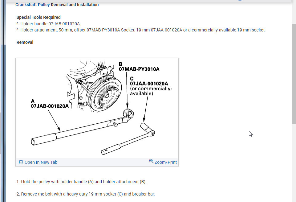

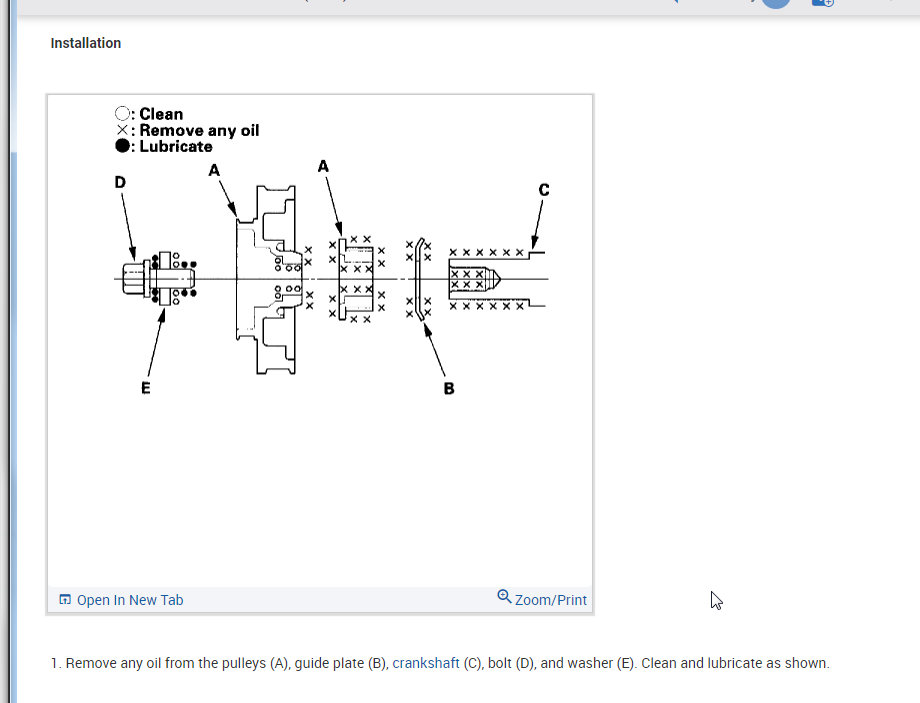

There are no sure ways to slow the leak. There are products out there that say they will stop leaks but once a seal is leaking it will only get worse.
You will need to remove the balancer so here is a guide that will help with this:
https://www.2carpros.com/articles/how-a-harmonic-balancer-works
Below you will find the process from the manual on how to replace this seal. I would suggest not putting it off for too long but the best thing to do is make sure the oil remains full until you get to it.
Please let us know if there are questions. Thanks
