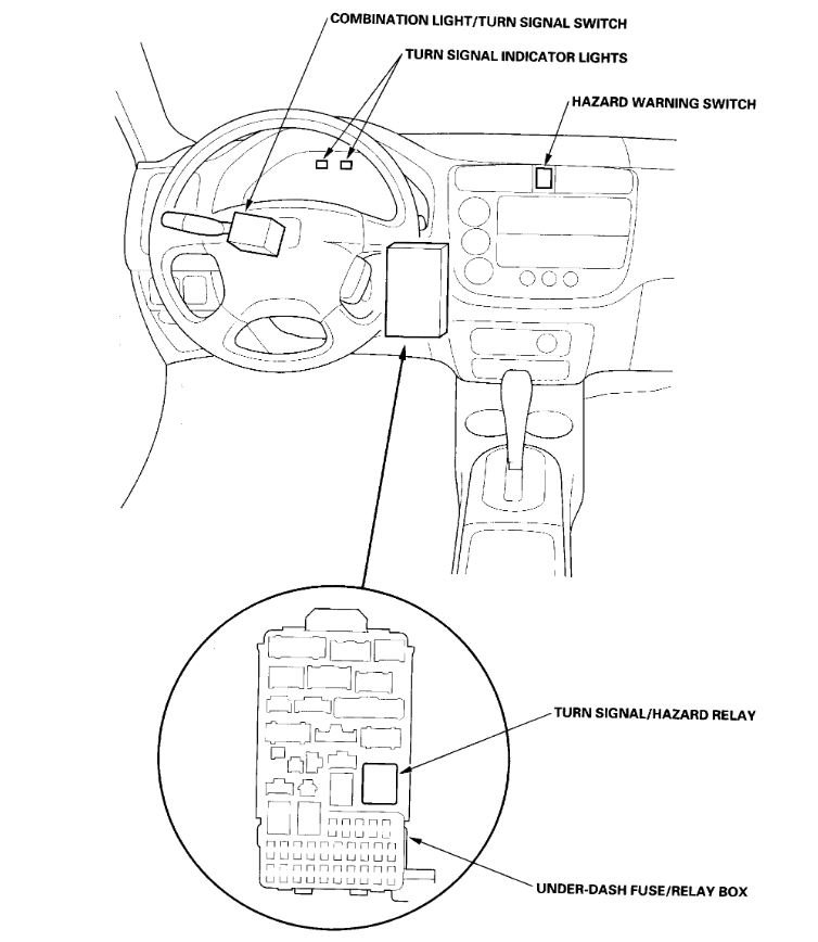

I Cannot Locate Where The Turn Signal Relay is? I looked under the dash Near the steering column bUt I cant seem to Find It Got a replacement for it from an auto parts store but the relay fuse looks way to big compared to the other ones can u help me out.

Your turn signal / hazard flasher relay is located in the underdash fuse / relay box ( under left side of dash) .
See the image below for location
