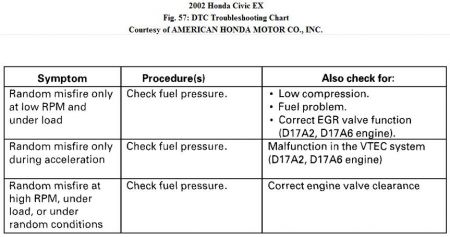

Th trouble codes indicate a misfiring in all the cylinders.
Here is a chart for the misfiring and what to check for.
https://www.2carpros.com/forum/automotive_pictures/192750_DTCP0300_02CivicFig75_1.jpg
The compression is rather high, specification minimum is only 153 psi.
Timing belt off a cog might not affect the compression much but it will affect the ignition timing.
Get a timing light to check the ignition timing and if it is out of specs, that would confirm the timing belt installation error.
If above all looks good, check the fuel pressure.
The fuel injectors could be possible causes too but it is not likely for all 4 to go out at the same time.
Another thing to check would be the valve clearances.
I have sent the complete diagnostic procedures to you as pdf files. It is too large to be posted here.
Let me know if it gets through correctly.
