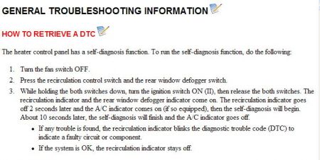

the a/c fan does not come on in the car
i removed fan under pas side fan is good
runs when power put to it
rep fan relay under hood did not fix prob.

Hi there, I had no idea that this can be done... we learn something every day, try this... Mark (mhpautos)
https://images.2carpros.com/forum/automotive_pictures/61395_honda_1.jpg

I will try this thank u I will let u know it does thank u devo
