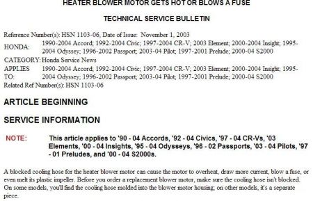

The blower motor has quit working in my daughters 2002 H. Civic ex. It also occured in my '97 civic ex and 1999 accord. any correlation?

There is actually a technical service bulletin (TSB) on your vehicle for a blower motor issue. This TSB also includes your other two listed vehicles so it may vary well be the same problem. Details of the TSB are below...please keep in mind that TSBs are to inform consumers of the situation and repairs are NOT free at the dealer as a recall would be.
