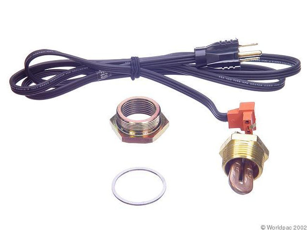

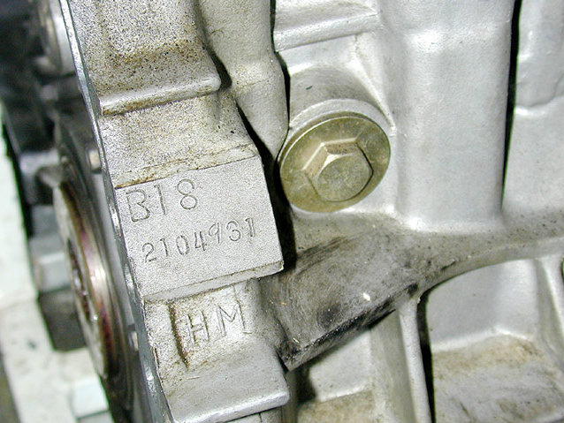

The block heater is located int he side of the engine block you must remove the plug to install it. Here is a picture of the location and the block heater itself which you can get from Amazon.
