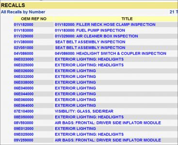

Hello - Also, one other thing while I have you, it looks like you may have some recalls on your vehicle. The dealer may fix these for free. Please contact the dealer service department, give them the VIN number of your car and have them check on these to see if they apply to you.
https://images.2carpros.com/forum/automotive_pictures/248015_Recalls_40.jpg

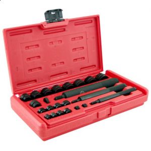

My lower control arm bushings are shot, probably related to the struts being bad for awhile and having crappy roads. While I'm replacing these bushings should I also replace the lower ball joints while I'm at it? I figure they are probably worn and I don't want to be going back in the future to do work I could do now.
I'm going to buy a 6 ton press to do the bushings, are there some bushing removal pieces I should pick up too? I'm excited and nervous to do all this but I"m thinking I can if I'm prepared enough.

Hello - My thought....you are there...it is apart.....you have to get the front end aligned....yes I would replace the other goodies as well...........smart move considering to replace them while there. Go to Auto Zone and use their tool check out and use the below for the various sizes. Many have tried using the kit instead of the press....and for some you can't get the angle you need or the force required. But you can save some cash and possible use the items with your press.
https://images.2carpros.com/forum/automotive_pictures/248015_Bushing_1.jpg
Just give yourself plenty of time, look at all things prior to taking apart to ensure putting together the same.........consider taking some photos if unsure prior to removal. Most of all..............BE SAFE..........and......have fun......... Good luck
