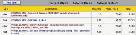

The lower left control arm on my civic is worn and needs replaced. It has been driven in this condition for months. I am curious as to what additional damage to my suspension this could have caused and what I should expect to pay in a reputable shop to have the work done.

Hello Thanks for the donation. Your wheel bearings may have been damaged as well as your tires while running with a faulty control arm. Inspect your vehicle's tire tread and replace as necessary. An estimate is below for removing and replacing your vehicle's lower left front control arm and wheel bearings.
https://images.2carpros.com/forum/automotive_pictures/261618_Noname_343.jpg

Thank you so much for the information. Nice to know before you take it in.
