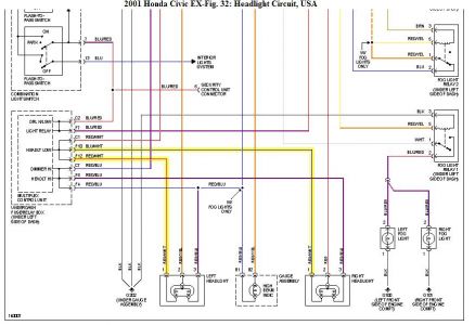

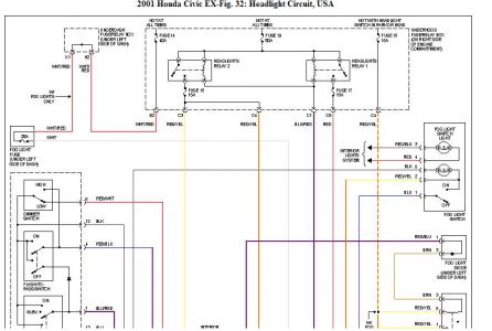

Both head lites are not working. Replaced the bulbs and fuses... Still not working.
High Beam works.
What should I look to eliminate next or can you advise.
John
Mar 14, 2009 at 7:34 AM
KHLOW2008
  • 41,814 POSTS
Hi John, I have the schematics here for you. Next item to check would be the headlight switch. Ground the switch Red/White wire and if lights works, you have a bad switch.
