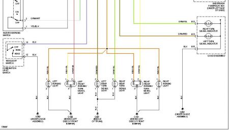

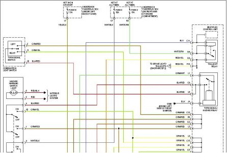

I am getting no voltage to the right front turn signal. I have tried 2 new bulbs, checked the fuzes and replaced the turn signal fuze with no effect.I cannot find a wiring diagram online and thought you mght have some suggestions. Thank you for any assistance.

see if this helps..
https://images.2carpros.com/forum/automotive_pictures/261618_Noname_1432.jpg
https://images.2carpros.com/forum/automotive_pictures/261618_Noname2_424.jpg
