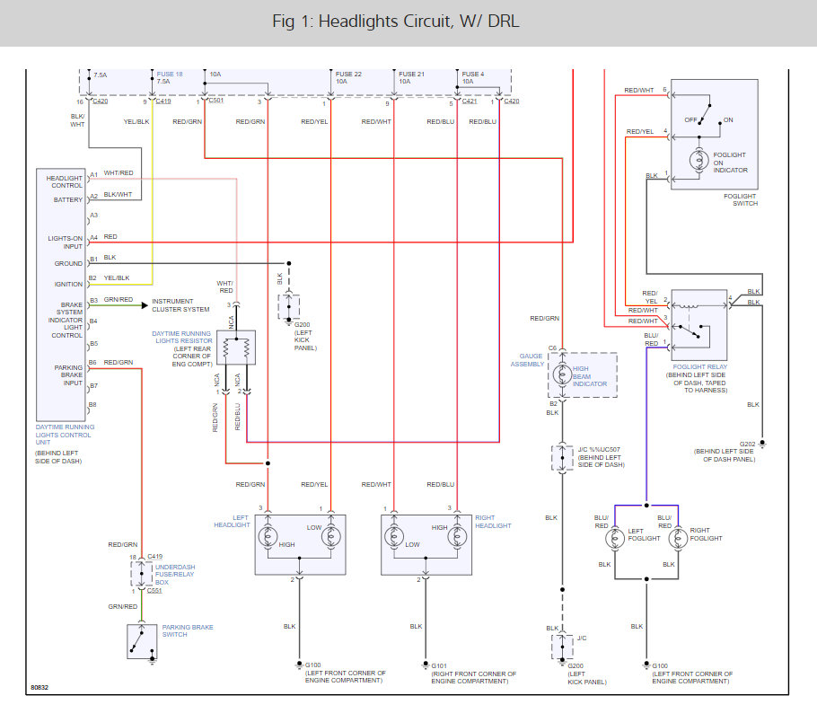

2001 Honda Civic DRL and high beams
160 MILES • 4 CYL • FWD • AUTOMATIC
RODRALPH
  • 5 POSTS

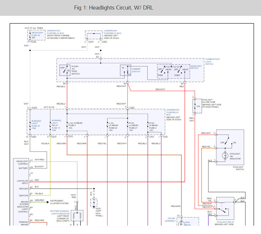

My son's Civic has no right high beam and the DRL's do not work. I would like to look at the DRL module, can you tell me where it is located? Also, is the DRL relay interchangeable with another relay in the sysgtem to check that possibility out?
Apr 11, 2009 at 3:59 AM
KHLOW2008
  • 41,812 POSTS
Hi rodralph,
Here is the schematic for the headlight system. DRL unit is located under left side of dash. It is not interchangeable with any other relays. Check out the diagrams (Below). Please let us know what happens.
